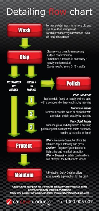

              I think that a thread such as this is fairly pointless, as dealers are franchises, and as such, each has different people performing the detail and they're likely using different products.
              The crux of the question has been answered in many threads already before. If you're going to do nanolex or any other type of wax or sealant once you take delivery of the car, then you need to go through the entire process...
              APC wash > Clay > Polish (if there are already swirls or paint issues to correct) > Pre-wax/sealant paint cleaner/bonder (optional step if required by your wax/sealant) > Wax/Sealant:
