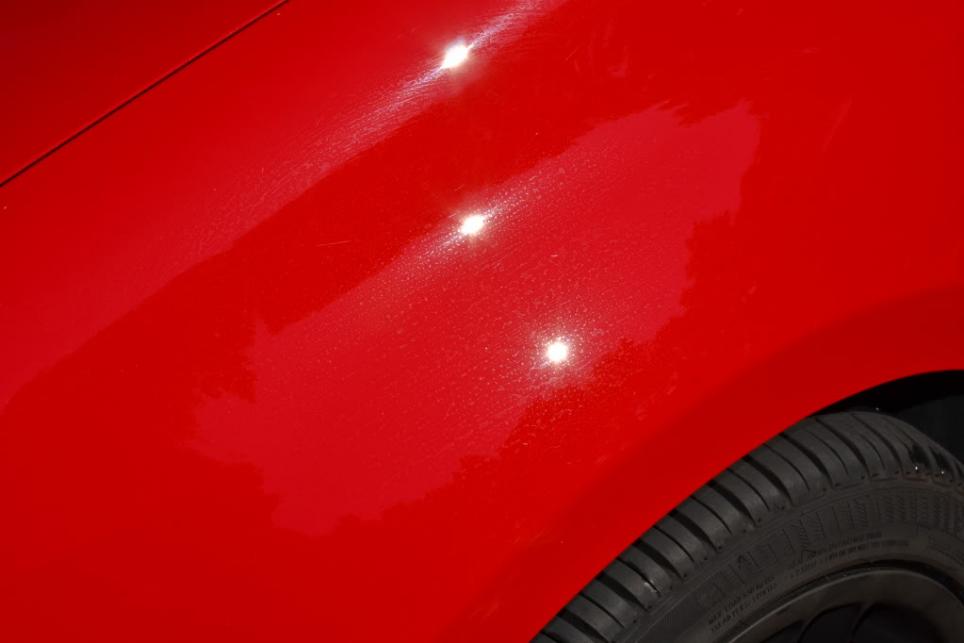

                Here are some pics,
                MK VI GTI / 5 DOOR / DSG / LEATHER / TORNADO RED / APR STAGE 1 / CARBONIO CAI STAGE 1 + 2 / VMR VB3 18" MATTE BLACK
                  Hey mate. To me that looks just like what gets left behind after rinsing with recycled water, and then when my microfibre waffle weave drying towel is too soaked and it's time to switch to the other one.
                  If you're getting that ALL OVER the car, and you're already using a good quality microfibre waffle-weave drying towel, then I can only assume that you really need to work on your foundation (what is sealing the paint) and/or start using a quick detailer during or after the drying.
                  I know that you've said you want to resolve this water streaking issue first, but the thing is, you need to get your foundation right first! If you go through the APC > Claybar > Nanolex Paint Cleaner then Nanolex Paint Sealant (as I described above), then not only will you be giving your car a great shine, and a great protective coating that will last a year+, but you will make washing and drying the car so much quicker and easier and probably resolve this issue you're having anyway. You'll need to switch car wash (again, as per my post) so that the wash doesn't remove or cover the sealant, but then dirty and grim won't cling as much, and water will bead better and come off the paint easier.
                  And a quick spray and wipe with quick detailer after each wash will take care of any final residue as well as deepen the sheen and add to the protective layer making your next wash easier again...
