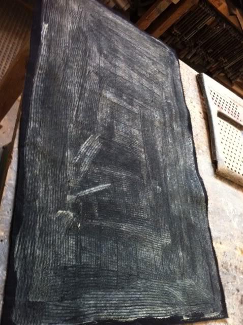

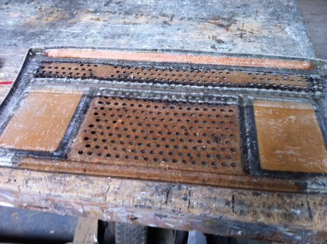

    first of all... to rip off the old fabric

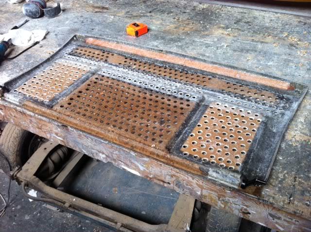

    where the speakers holes are, we want to cover it up so... i cut out a rectangular shape, so i can splice a piece in.

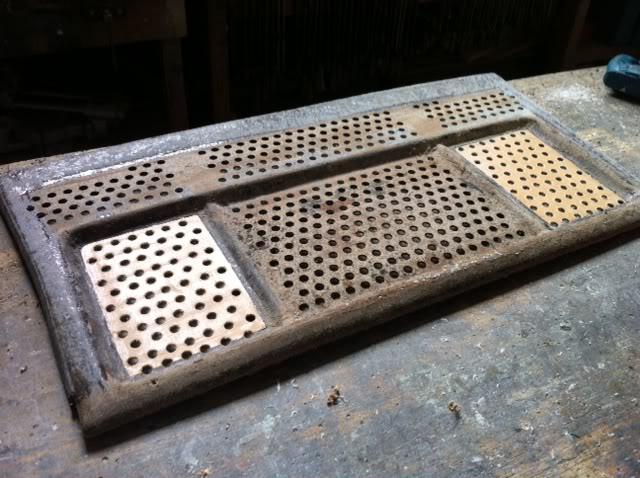

    grab some chipboard/plywood whatever material the same thickness as the shelf.
    then cut the piece about 12mm larger than the hole you've just cut in the shelf (leaving 6mm on each side)..
    to splice, chamfer all edges on both the outside of the insert and the cutout to make the piece sit neatly in the cutout.
    after both are fitting nicely, place some epoxy on all chamfers on both mating sides.
    the stick down and place some weight onto the parts.

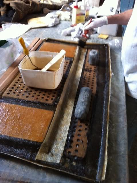

    after epoxy has set, cut some fibreglass out to glass the underneath side of the parcel shelf
    and also, because my parcel shelf has a massive bow in it i made up some strips of timber to stiffen it up.
    next step, glassing.

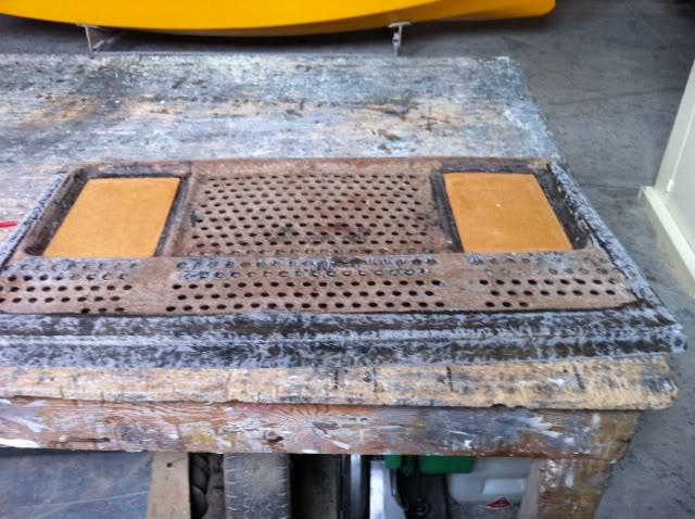

    apply some more glass onto side and front edges to stiffen up even more!!
    after finished glassing let resin set, then grind and sand back till smooth.
    then to keep it OEM, drill some more holes

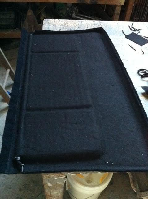

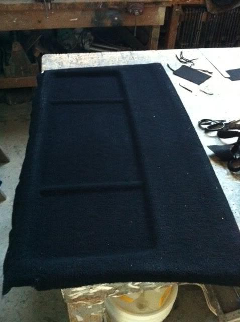

    next step is to apply the fabric.....
    i found out the OEM fabric is black front runner and some felty sort-of carpet stuff,
    which i bought from Australian Trim Supply in Dandenong.
    what you also need is some Kwik Grip Gel (from bunnings). not normal Kwik Grip as it will seap through the fabric
    firstly cut your fabric roughly to size (leave a fair bit extra) and smear a thin layer of the gel all over the fabric and on the parcel shelf,
    wait until the glue has gone off (not sticky) and then start applying fabric, starting from front and working to the rear.
    do the same with the underneath side.
    join both the carpets together, let it dry a bit to stick better. then trim all edges until looks how you want it.
    And Voila, a new parcel shelf!!!!
