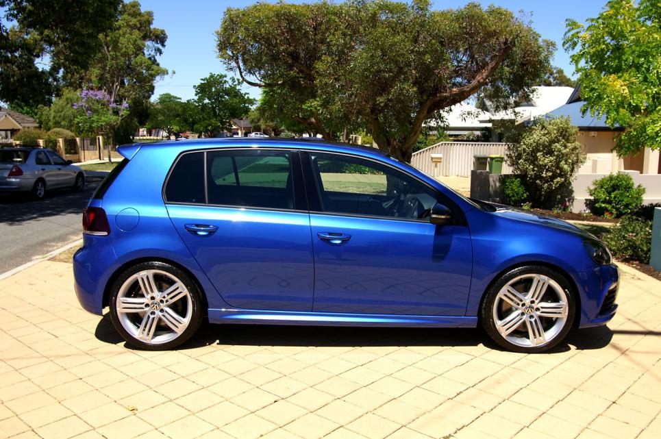

                      I've got the Opticoat and very happy with it, the shine is awesome, even after 5 months! FYI I was told by the supplier that the Opticoat on top of ventureshield is not good, not sure why though!
                      Windscreen chips are a nuisance, I had one recently a 5cent piece sized crack which was fixed by O'brien's for around $150 and you can hardly tell it was there, so in some ways they can be fixed sometimes!
                      Here's a pic of the R straight after the opticoat was applied

                          Shakespeare, good to here you are rapt with the application. Can't remember reading anything negative about it. Nice pic. Only Blue will do! (Only a friendly stir to all non blues)

                            0 stone chips on the front, only 1 on the windscreen, which was actually kicked up from oncoming traffic on a Mazda cruise of all things!!! (quickly touches wood and trys not to drive on loose surface roads with cars in front)
