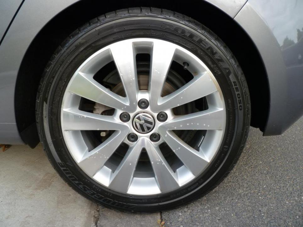

      • Wheels and tires dried and some Autobrite berry tire gel was applied to the tires.

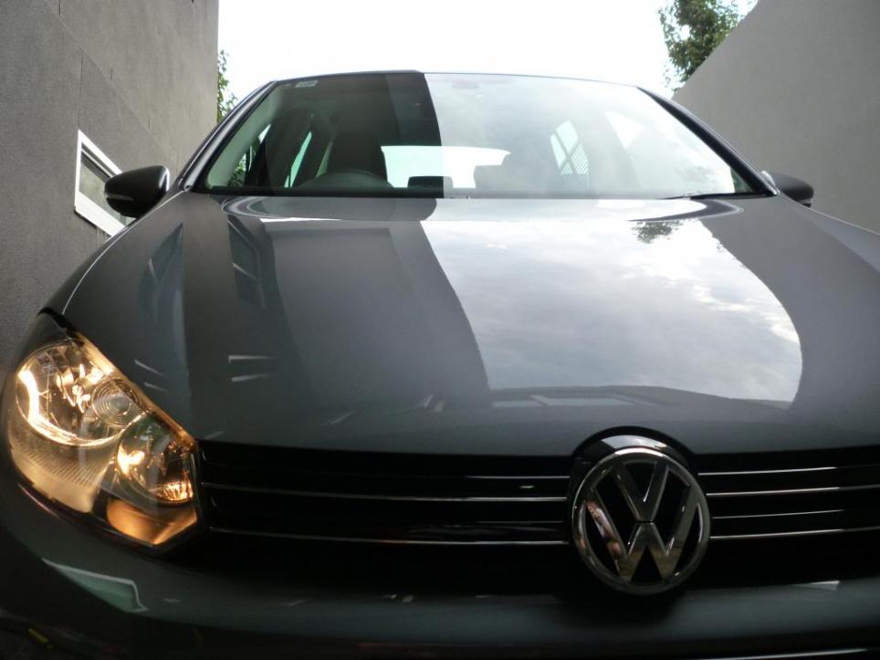

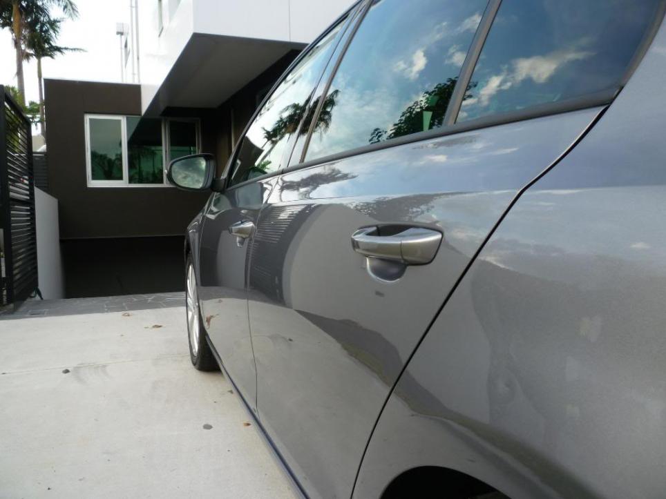

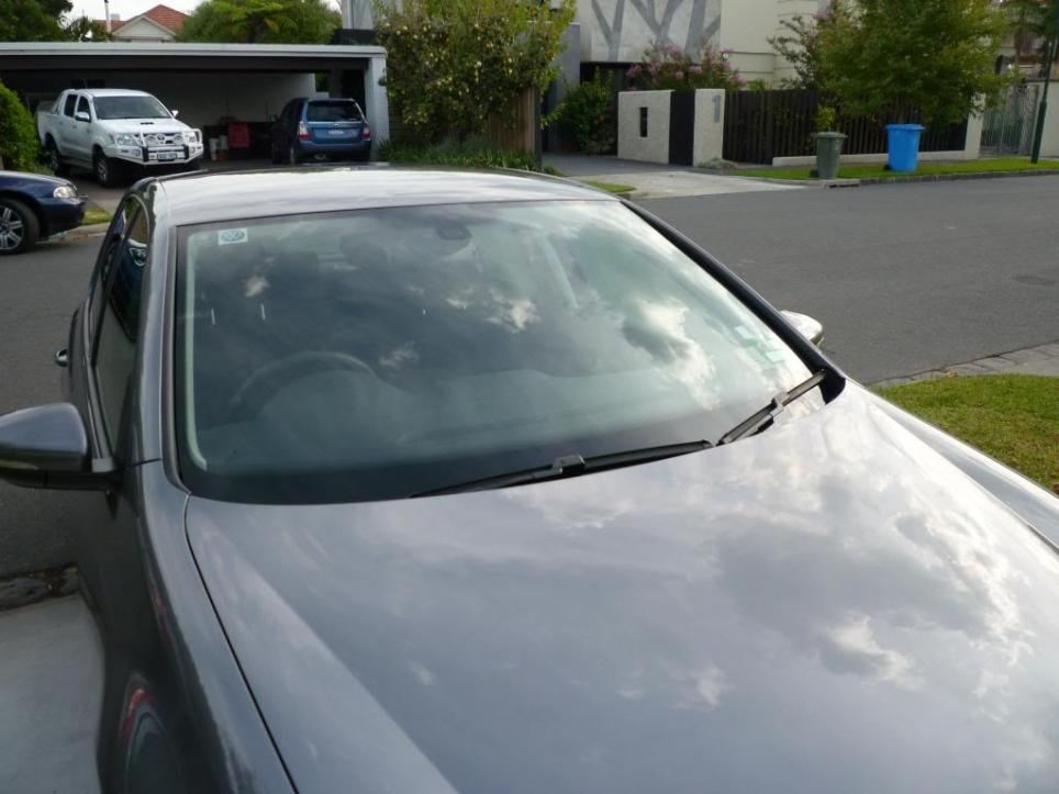

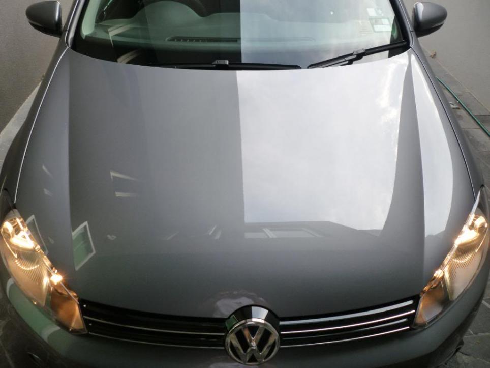

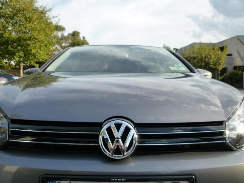

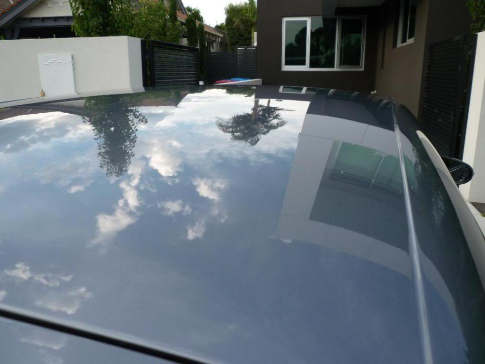

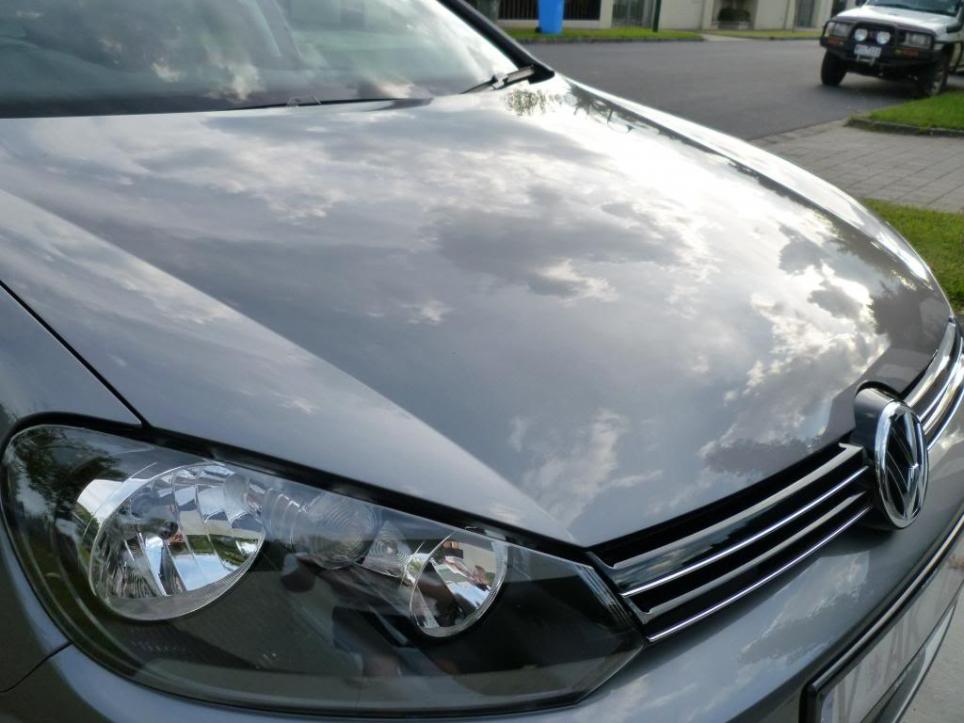

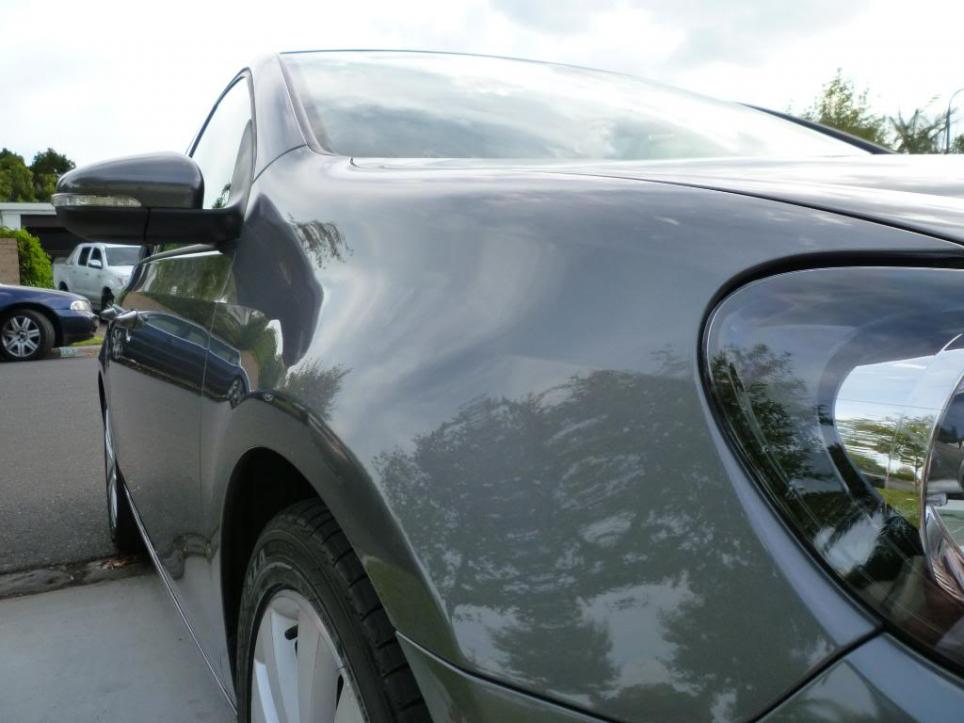

      • The paint was then treated with Zymol HD-Cleanse to ready it for the wax.
      • And finally the car was waxed with Zymol Titanium Wax. This is the kind of wax that needs to be massaged in by hand and buffed off shortly after.
    Here are the results. (sorry about my amateur camera skills)
    Now just leaving the wax overnight to fully cure before i give it another wash and add some Dodo Juice Red Mist to bring out some extra gloss!
    Almost all of the products used were sourced from CCP so would like to thank them for their great service and reliability.
    Happy to hear what you guys think and any tips you may have.
    Thanks
    Terrible, unbelievably terrible.
    Looks fantastic mate! Love it.. came out really great. You can see a lot of depth into the colour now most definitely in comparison to most i have seen around.
    I did notice or maybe could be what you used, but did you apply tyre shine when the tyres were still wet? haha.

      And no the tyres were dried but the rims were still a little wet. Got a bit lazy. :p
      They might look wet because I put three layers of the autobrite gel to give it more shine...Guess I can say the product is working then.
