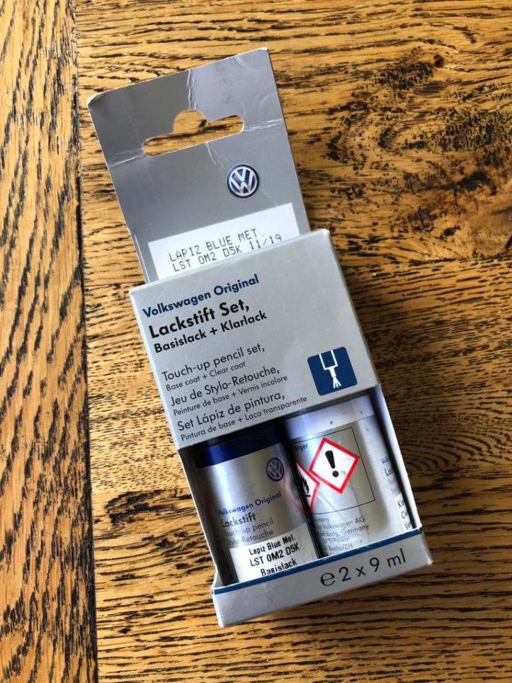

                  What is the go with the VW touch up paint bottles? Tried to order some and the parts department are saying that Volkswagen have placed a stop on selling them.
                  Looks like i will have to try Dr Colorchip.
                    [ATTACH=CONFIG]34861[/ATTACH]
                    Just got mine in yesterday. Maybe call around to other dealers. Didn’t have any instructions included. Searching to see how easy it is to get done this afternoon.
                        I see you got Lapiz blue. Do you mind telling me how much it cost from your dealer?
                          About $25 at Waverley VW.
