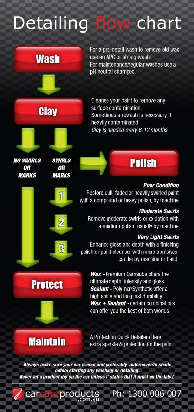

    Hi Guys,
    A number of you have said it would be great to have a simple 1 page chart that takes you through the steps of detailing and briefly explains them - so we have listened and come up with the CCP Guide to Detailing Flow Chart.
    Here is the chart which shows you what process follows what, and you can download and print a copy for yourself here: Guide To Detailing Flow Chart
    Any questions - as always please feel free to call, PM or email

      Thanks for posting that... I was going to email you and ask you to send me a copy as I forgot to take a copy on Saturday at the clinic. Muchly appreciated!
        thanks heaps for that- great way to break it down for those like myself, who used to think that a hand wash and chamois dry was caring for the car...

            OK Iam dumb but whats this clay. I know its not the stuff our country roads are covered in. Surely??
            Swirls??? Iam guessing circular rings in paintwork after dubious polish
            In the auto acc shops there a machine polishers with 2 large D hanles or a polisher like a large angle grinder?
              Why not have a look and a read through here, it should explain everything you need to know about clay, machine polishing and more: http://www.vwwatercooled.org.au/f22/...ary-34332.html
