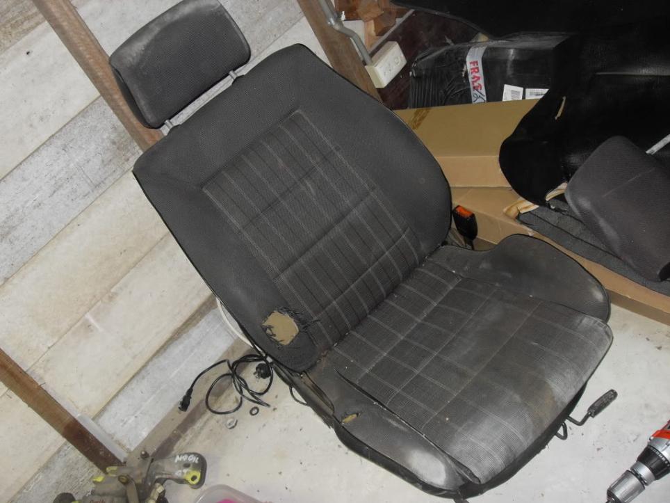

    Some pics of some GTI and Cabrio seats I am doing at the moment.
    Typical damaged GTI seat

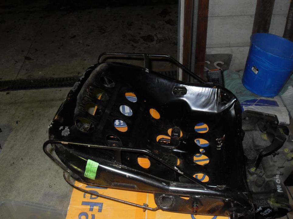

    Base of seat with foam and skin removed
    Different seats have hoops or not. GTI and VR6 have hoops in the side bolsters, CL and GLs and SEATs and Mk2 non GTIs have no hoops. Mk3 Cabrio has GTI style bolsters, but with hard foam and no hoops! This base is from a Mk1 GTI.

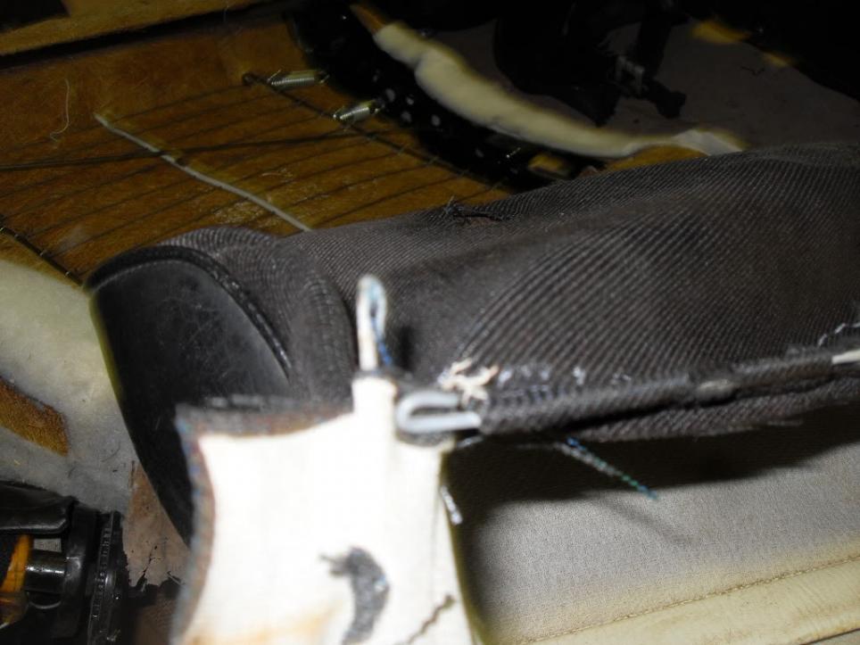

    To get the foam off the base is not very hard, turn it over and it has two loops of wire around the rear legs, loosten them and undo em with pliers and the skin will slacken. Then there are 2 hooks toward the middle of the seat, these need to be bent out with a flat screwdrivrs so the fabric can unhook. at the front there maybe clips or screws or a cover, depending on model, remove these. The back is tucked in, the fabric has a big cardboard seam, pull this out of the metal frame and the foam bolster and fabric will be free.

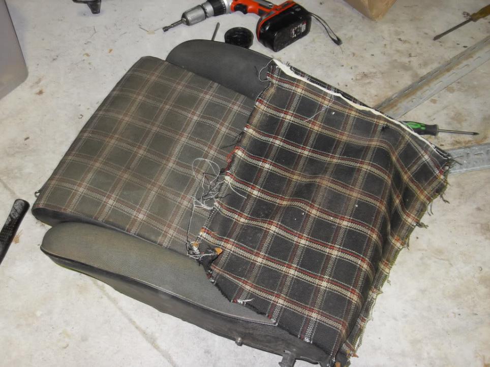

    Seat squab with fabric attached. This pic also shows how clean the fabric is on the other side if you remove the foam etc.
    You can unhook the fabric from the bolster by turning it over and taking the fabric off inside out. There are wire rods with hooks and twisted loops of wite to overcome, all of which can be done with pliers, cutters or a screwdriver.

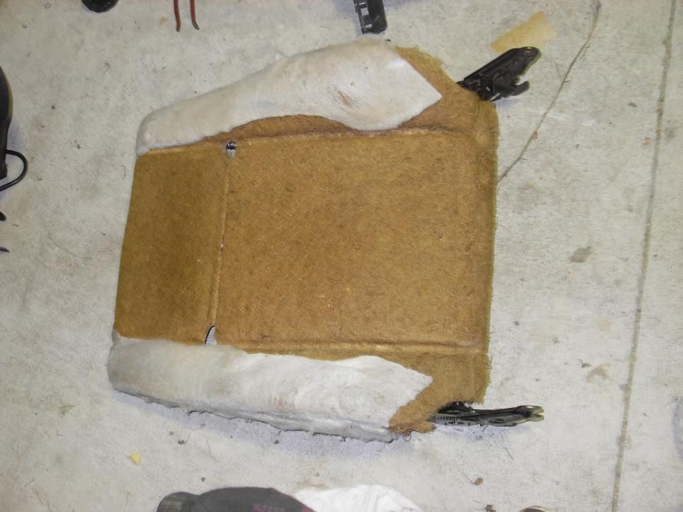

    You are then left with this
    Now is the perfect time to swop it for one from your donor seat if yours is trashed.

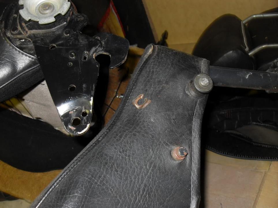

    Mk1 GTI Seats are a little different to other VW seats. The bolsters bolt to the frame and the seat squab is separate.
    Easier to dismantle this bit though and this pic shows how much the fabric has faded in 30 years.
    The top halves are a little crazy too
    If you stick yor hand down the seam of a Mk1 GTI GTI seat, you can feel the springs and seat frame.
