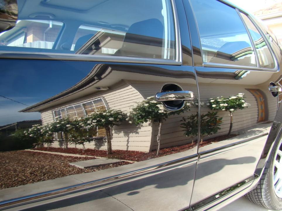

              Just thought i would throw this in. My old 2001 Mk4 GTi was in need of some TLC so after HEAPS of research i found paintprotectiondirect.
              i called up and got the number for the Melbourne person. Got the car done which removed swirl marks, scratches and limited some of the stones chips i got from a trip to QLD. this was the result...
              ive got more pics if you wanna see them!
              i'd happily head back to him with my R32.
