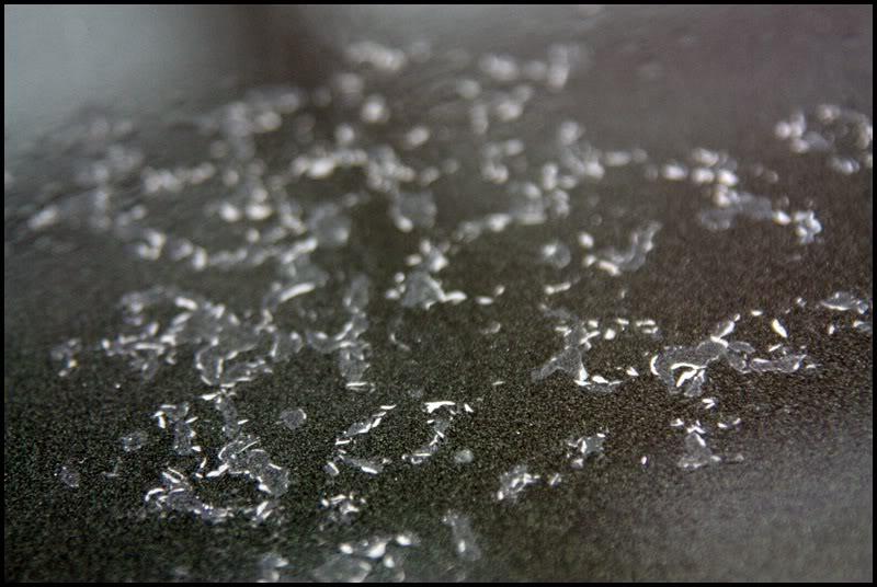

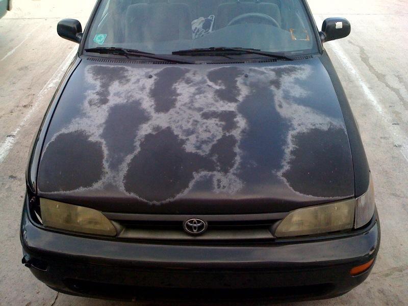

Why Does Clearcoat Fail?
So now we have an understanding of what clearcoat is we can look at what causes it to fail.
There are three main causes to clearcoat failure:

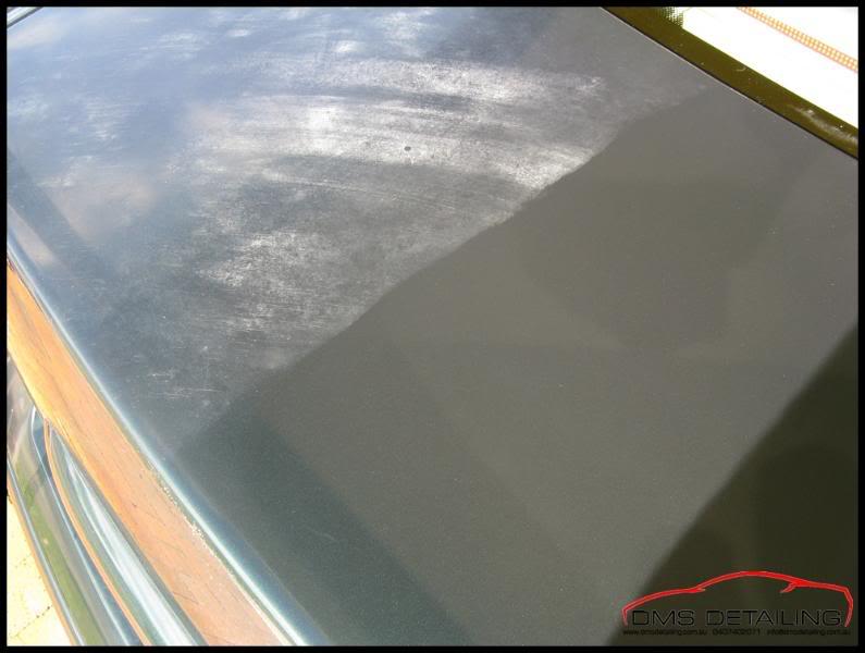

1. First is impropper paint bonding. This occurs when the clearcoat is layed down incorrectly over the colour coat. The bond between the two is not achieved and as such the clear will slowly begin to bubble and peel from the vehicle. This picture shows the failing clear on the left hand side of the boot lid. The right hand side had a filler wax applied to mask the problem for the owner.
2. The second is removal of too much clearcoat. This often occurs when the vehicle has been agressively buffed a number of times or if the vehicle has been wetsanded by an inexperienced operator. This leaves the clearcoat thin and as such it's UV blockers are removed and it gives in to the effect of the harsh Australian sun.
Image care of Autogeekonline.net
3. The third is lack of protection. Some people just don't look after their cars and as such the paint work never saw any wax or sealant. Over time the effects of the environment took their toll and you're left with a mess that needs to be sprayed to be fixed up.

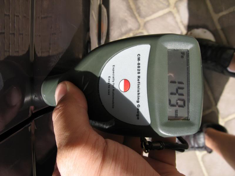

2. Secondly be wary of who machine polishes your vehicle. A lot of unskilled tradesmen will use agressive cutters that will remove a lot of marks but also a lot of paint. Ensure that anyone that is agressively correcting your vehicle either through machine polishing or wetsanding is experienced as is using a paint thickness gauge (below) to assess how much film build remains between all the steps.
