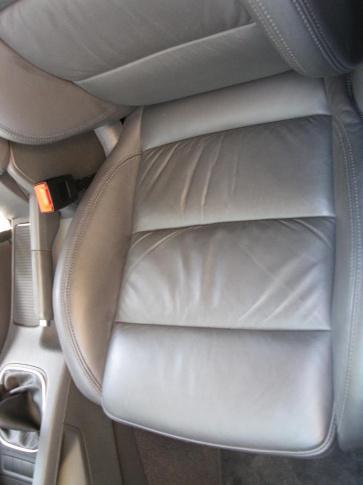

    What I want to know is how to get started if they have not been done since purchase (we got the vehicle in 2007 but was brought prior in 2005).
    The manual stated that every 2 years Leather Treatment should be applied I bought Audi Leather Treatment but have not noticed any major difference in looks only softer in feel.
    Am I doing it all wrong ?

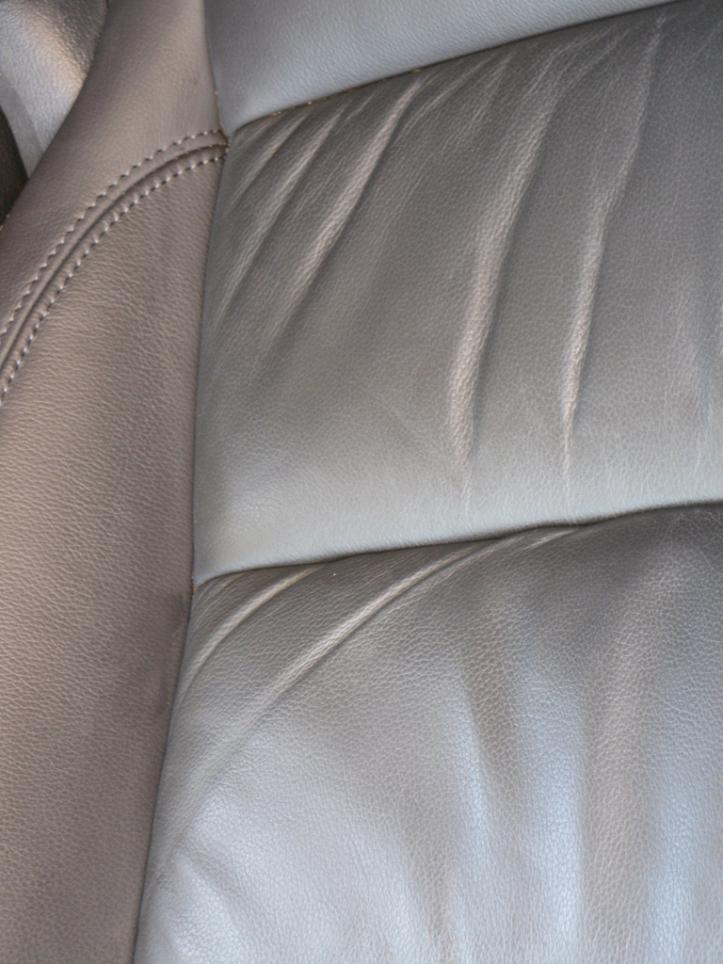

    Also there are creases in the front passenger seat can they be revived ?

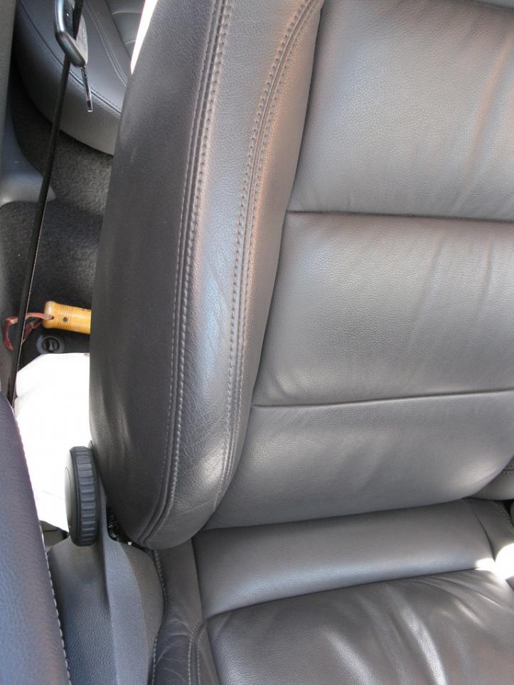

    The wear on the drivers side bolsters - still treatable ?
