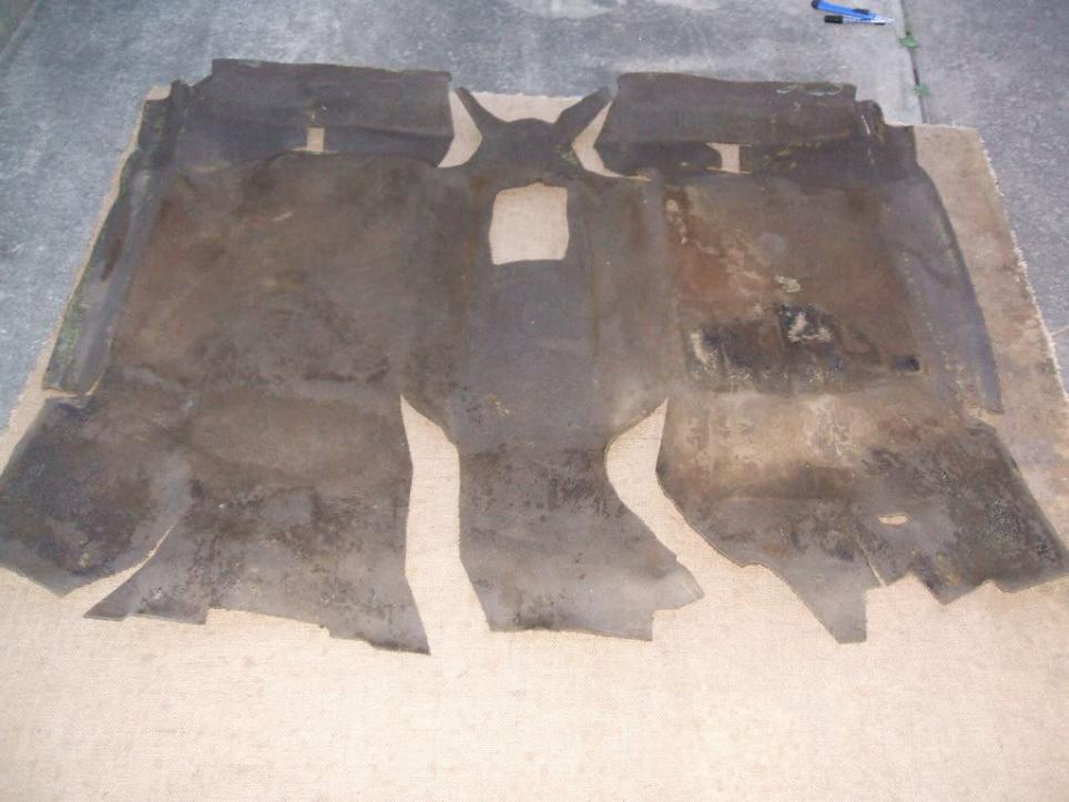

    well the lead up to the 'nats has made me go a little silly and i thought i'd cut up an old carpet i had... for the good of all ofcourse.
    what you do is lay the carpet down, and cut lines in it suc hthat it will lie flat to the ground.... this gives you a "net" - remember from primary school?
    you'll find that the cuts you need to make happen on diagonals and end up making little v shapes once the carpet is flat. you may also need to cut right through some sections and have a totally disconnected flap.. this is ok.

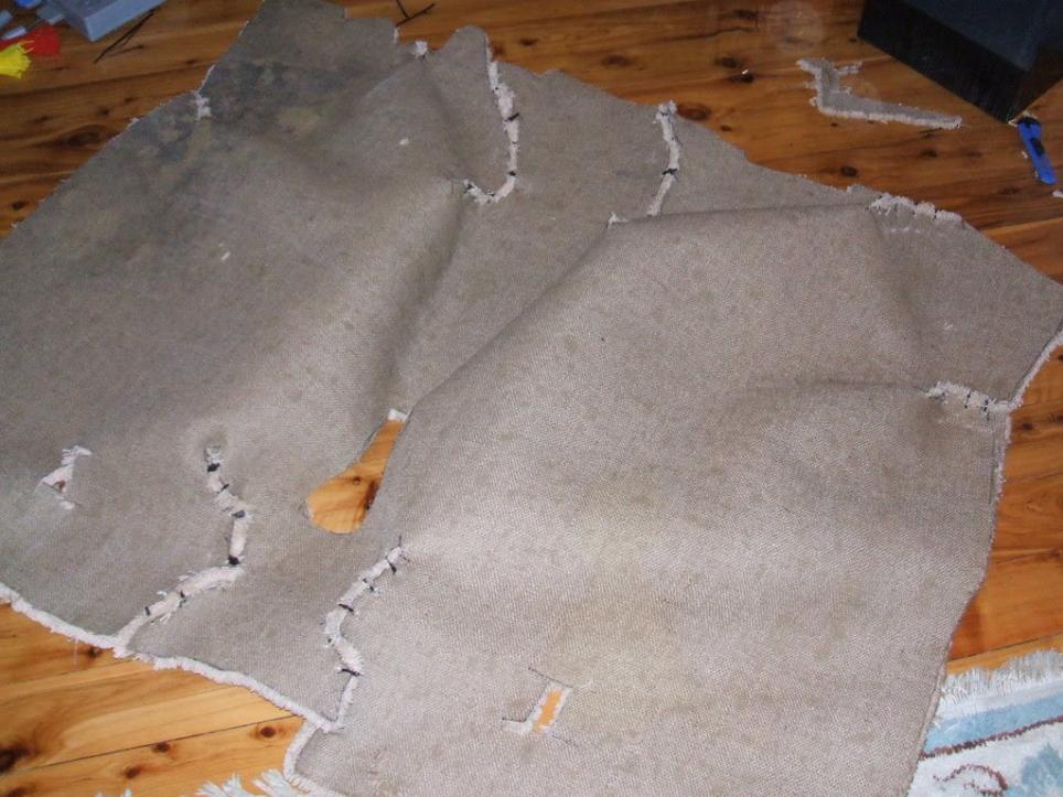

    once your net is done, lay it upside down ontop of your upside down new piece of carpet. you can mark out with a marker where you need to cut. also mark out specially where you have cut the original carpet, so you know where to jointhe new one.
    cut out your new "net" with a good sharp razor blade knife - use a cheap one, with the snap off blade but extend it out to a few inches or you'll be cutting carpet forever

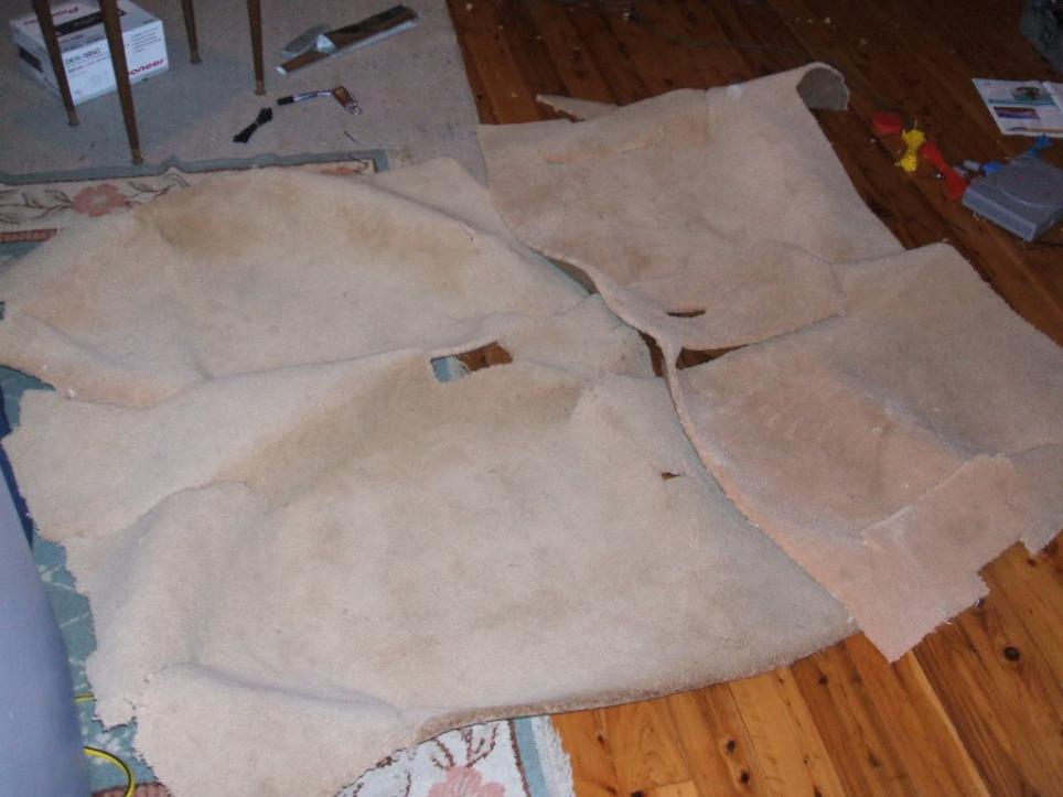

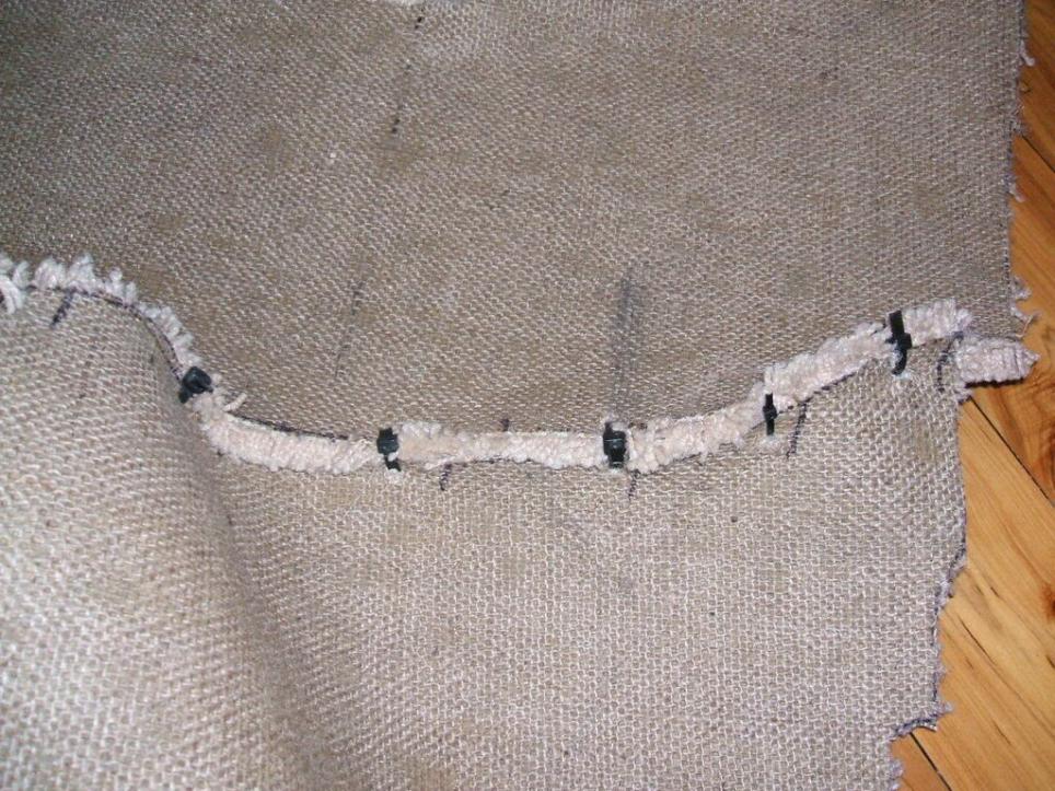

    once you net is cut out, you can begin "stitching" it together at the cut places. this will form the shape of the carpet. i've used zip ties because they are quick and easy, and this is an experiment. you may be able to improve on this with some colour matched embroidery thread and a nice big needle. i doubt it would take much longer to do it that way.
    you can stitch the whole thing.... make sure you stitch it on the underside silly!
    when you've done stitching, flip it over...
    '98 Mk3 Cabriolet 2.0 8V
    '99 A4 Quattro 1.8T
    surprise!
    magic! new deep pile carpet... cost me about 2 hours and some zip ties, the carpet is an offcut.
                  If you wanted a more permanent join, you can use a curved needle (similar to the suture needle used by surgeons) or iron-on fabric tape. I would use both if I wanted the joins to last
                    cheers brackie, thats the kind of needle i was thinking of...
                    also note everyone, you cant even really see the joins since the pile is so deep the join is beneath the surface...

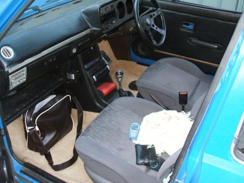

                      interior shot
                      i don't know about you guys but i reckon this is pretty cool yeah?

                          how is it wearing?
                          not bad!
                          all the joins are intact, surprising me. the carpet fit is exceptionally good, just looks right everywhere. the deep pile seems to get a bit messy easily, and the part where my heel rests on the floor under the accelerator pedal has lots its texture and kind of looks like where your couch sits on the carpet in your house.
                          i'll be making one for the new LS pretty soon i think.
