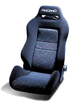

      These are the seats, same centre fabric design aswell so will match the wack mk3 interior quite well me thinks

            I thought about getting some stock VR seats, but I love these seats too much. Comfiest seats ever for daily and track use and they are damn cheap hehe, plus Id like to do something a little different
