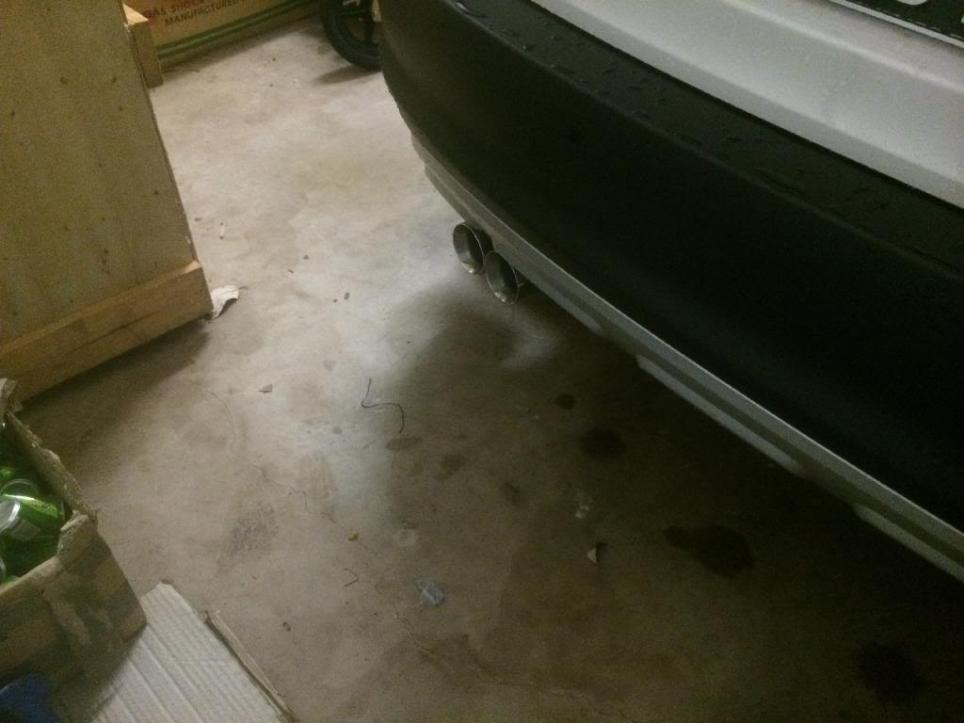

        Sorry about the car being a bit dirty but it's wet season up here at moment so it's raining near every day.
        Don't forget about the VCDS changes too. I changed my coming and leaving lights to my fog lights instead of the Bi-Xenons also added the needle sweep so the speedo and Tacho do a sweep every time you turn the key.
        Happy Days.

          Thanks for the pics. The tips look good.
          Where yours has the flange mine just keeps going into the muffler.
