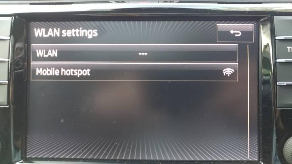

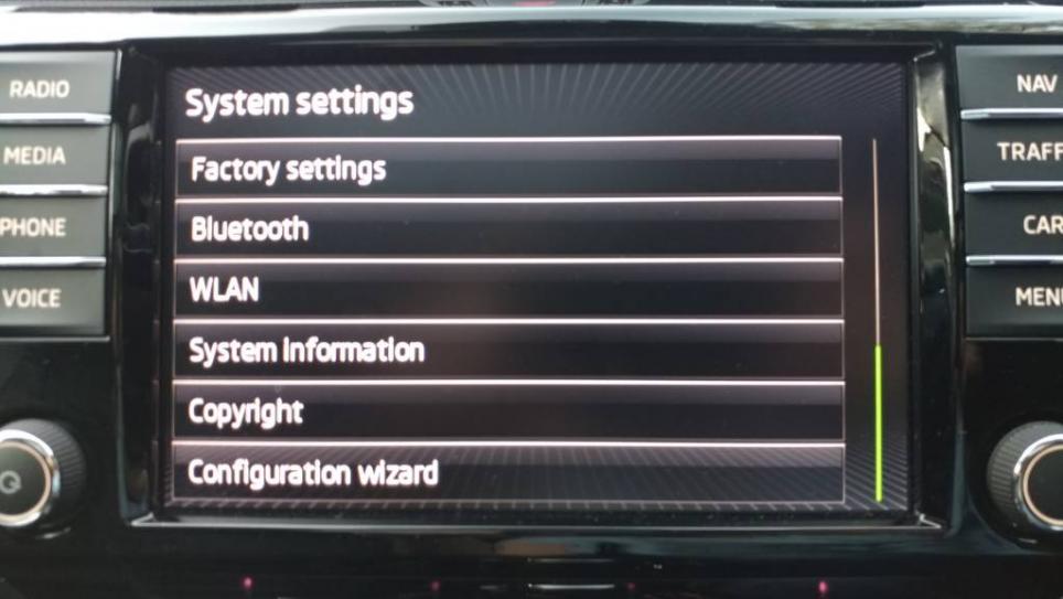

                        I have the below entries in the Menu --> System Setrings --> WLAN
                        If you don't have them, then they must removed WLAN in MY18
                        Sent from my LG-H990 using Tapatalk
