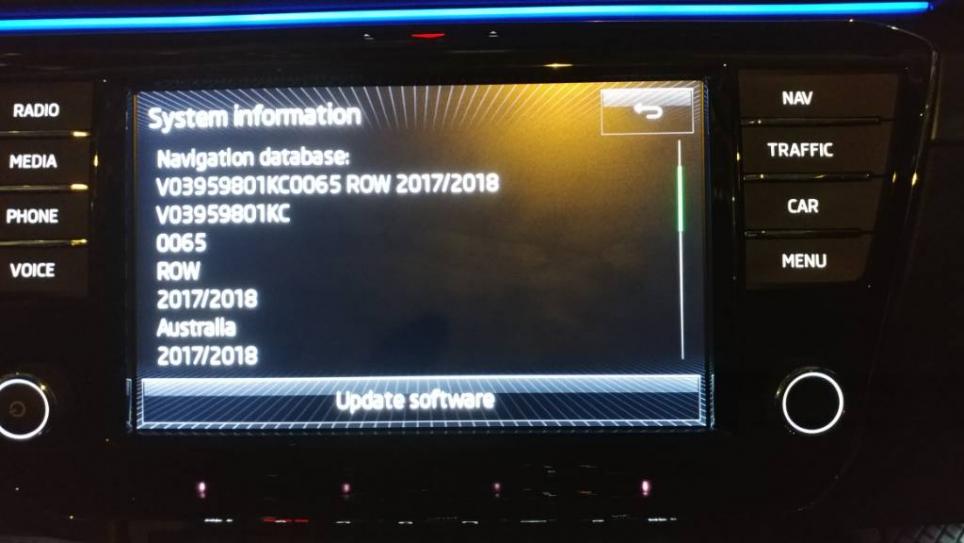

          • #20
            Originally posted by Vexed View Post
            I have checked for my car today. There is a new version for sure.
            MRM 2017/2018 (Unknown)
            Downloading now.
            Version info after the update
            Sent from my LG-H990 using Tapatalk
