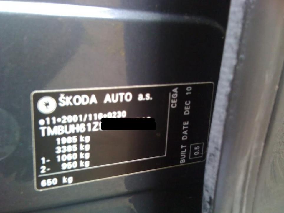

Just out of interest, would you be able to post a photo of the tyre placard from your vehicle? I'm trying to work out why the Michelin website lists the 91 load rating tyre when searching by "Skoda Superb Elegance".

My tyres are a 91 rating, but let's not get too excited and yell they aren't suitable. The allowed wheel loading is 615 kg per wheel x 4 = 2460 kg. A Superb does not weigh that much and even if the weight distribution was 70/30 to the front the wheel loading would not exceed that figure. The 94 is overkill for the car.

Rather than being fixated on the gross vehicle mass, it's much more important and relevant to focus on the maximum front and rear axle loads of the vehicle. This information should be on a placard affixed somewhere near the bottom of the B-pillar or sill:
This is what's known as a manufacturer’s statutory plate (or "type-approval plate", or "type plate"), which is affixed to every vehicle sold in the European Union, and lists the vehicle's GVM, GCM, maximum front and rear axle loads, and maximum unbraked trailer load, amongst other information.

Even if the maximum axle load does not exceed the maximum load capacity of the tyres, manufacturers don't use this information as the sole indicator in determining what wheel and tyre assembly is suitable for the vehicle. As would be expected, vehicle manufacturers take into account a wide range of variables (including safety margins) when determining such matters, in order to ensure the vehicle remains safe in all conditions that it would reasonably be expected to encounter.
