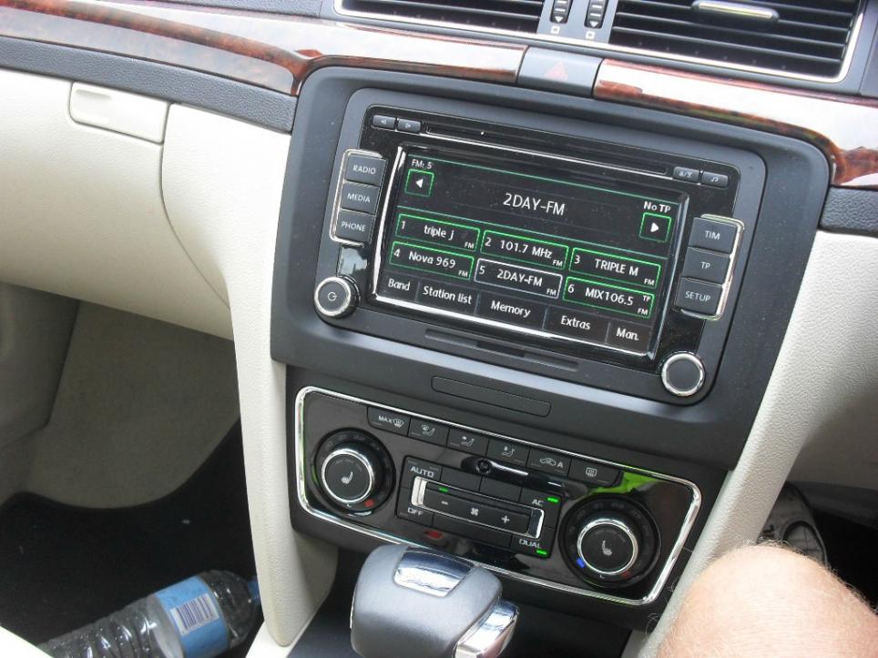

    is it possible to add bluetooth to this radio?????????
    that's the bolero (RCD-510) unit.
    yes it is possible to fit bluetooth.
    9w7 is a popular choice. can b sourced from ebay. u'll need the one which comes with a mic, as the bolero does not come with voice-control.
    have a look at carsystems - they have a few oem units.
    then there is the fiscon units.
    dealers also have a version, not sure which one.

      have fitted mobridge also
