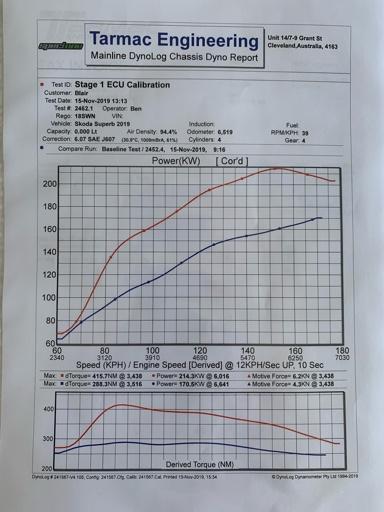

    Curious to know what the real "at the wheel" outputs are as a baseline ahead of any future mods I booked a dyno run at Race Torque Engineering here in Perth. One of the owners Lane is a VAG fan who drives an Octavia RS245, and they have a history with Skoda preparing the factory Team MRF Fabia rally cars. His workshop was full of Evo's and WRX today although there was a tidy Kombi rebuild underway.

    I had a baseline of 170AWKW prior to my dyno tune, that was with intake mods only.

        Couple of questions regarding your figures.
        a) What engine and official rated power/torque figures?
        b) Were your measurements at the wheel or as extrapolated flywheel figure?

          I did the same thing, weighed up warranty etc and decided to go for it anyway. Was less than 12 months old and only had 7,000kms. For minor warranty issues it shouldn’t have any detrimental effects.
          I went custom stage 1 ECU and TCU through Tarmac Engineering in Brisbane, and I’m pleased with the results and how it drives.
          0.9 bar is a bit low, stock they are 1.2-1.3 from memory. Peak is now 1.8 bar.

            A) 206kw and 350nm is stock flywheel figures for a Sportline.
            B) The dyno sheet is at the wheels. Add ~20% to these for approx flywheel figures.

              a) Car is Sportline 2.0tsi 4x4 - officially rated at 206 kw & 350nm
              b) At the wheel
                I'm interested to understand why the the lower stock boost on mine and will have a look around to try understand better, the following suggests 1.2 as you said
                For high-performance vehicles, the engineers did some improvements in the design. The engines with code CJX have slightly different cylinder head shape, performance intake camshaft, bigger exhaust valves, reduced compression ration to 9.3:1, new pistons, more productive injectors, and high-pressure fuel pump. The engines are turbocharged by IHI IS38 with the max boost of 1.2 bar (17.4 psi)

                  Do you have the Sports Instruments in yours? You can read boost off that, although note that this reads atmospheric so you need to deduct 1 bar from the reading
                  Sent from my iPhone using Tapatalk Pro
                    “Do you have the Sports Instruments in yours? You can read boost off that, although note that this reads atmospheric so you need to deduct 1 bar from the reading”
                    Yes I do have the sports instruments, I just don’t know of somewhere I can safely replicate the Dyno run and read the boost gauges in the centre screen. I think it would be better to have the boost show in the virtual cockpit, hmmm I wonder if that could be coded...
                    The technician operating the dyno commented on the boost being lower than expected, and led to me wanting to learn more about what drives variation and changes in boost pressure
