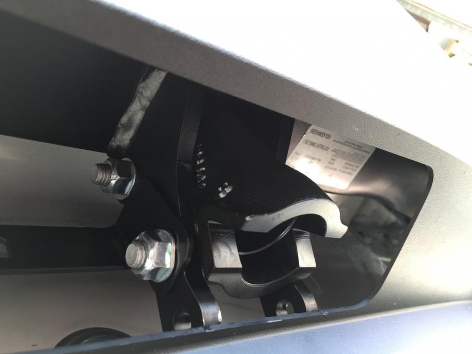

    Towbar in installed position. It basically replaces the crash bar location. But bolts on down the chassis rails instead of on the end of them:

    Where the gooseneck fits into place:

                      so, towed around 1300kg of trailer and racecar last weekend. traveled fine!
                      found a minor design flaw with the gooseneck attachment/detachment wheel.
                      when you want to detach the gooseneck, you turn the wheel away from you, the top goes towards the front of the car. well, when i ran over a kangaroo on the highway, the carcass of the roo kindly detached the gooseneck on my behalf, while i was traveling at around 70-80km/h.
                      thankfully, the trailer hitch got stuck under the boot floor and i brought the whole thing to a stop safely. managed to drive it all home - once the goosneck was kind of forced back onto the car.
                      anyway, you'd think the europeans would have thought of that! im getting insurance to install a HR bar, might look ugly, but roadkill wont actually attempt to kill me lol

                        Does it not have a key to lock it. My westfalia has to be pulled away from the neck before it will turn and won't turn or pull out without the key inserted and turned
                        MY16 Candy white Octavia VRS Wagon, sunroof, 19" black pack, tech pack, comfort pack, auto tail gate
                        MY12.5 Polo 6R GTI
                        • #57
                          yes it does. and it was locked and the key removed.
                          but put enough force on anything in the right way and it will break. it was a big roo
                          ill ask for the gooseneck back once the car is repaired, and ill have a look at whats broken. might take to it with an angle grinder
