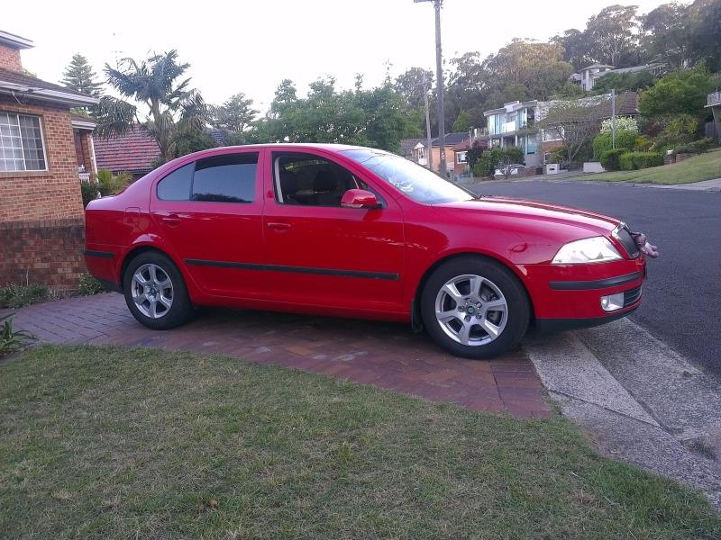

            Here's mine with those wheels & 225/55r16
