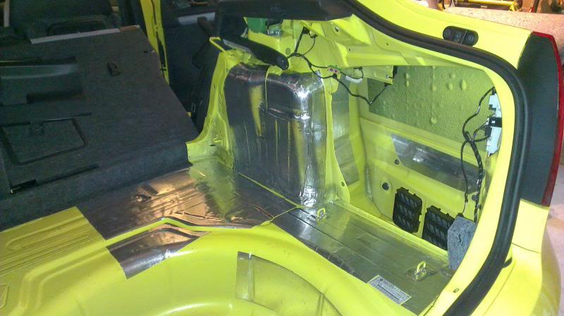

                        • Add the sound deadener under the passenger seat
                          • this is my attempt at sound deadening the boot area......
                            mirrored the same for the left side.
                            i'm tempted to put some sound deadening carpet under the parcel shelf too.......
