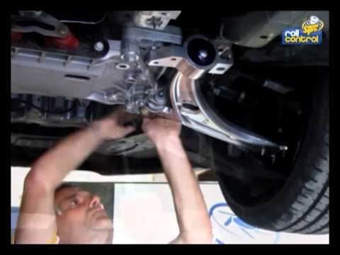

that's not right. shouldn't get that sort of movement from the rear bush. the arm shouldn't move that far forwards/backwards due to the poly bush on the front, and the push tube that sits in the mount. I rekon there is an issue elsewhere, or the rear mount where the movement is, needs to be moved further forwards. there is some movement in the mount
