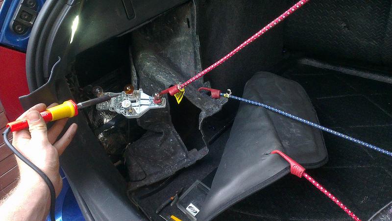

    Ocky straps everywhere!!! Handy to hold stuff out of the way instead of removing them :p

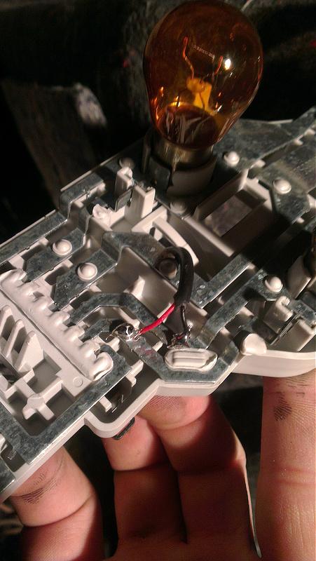

    Where I soldered on to the reverse light so it only comes on when in reverse
    See where I ran the wire through the circuit board and the air vent?

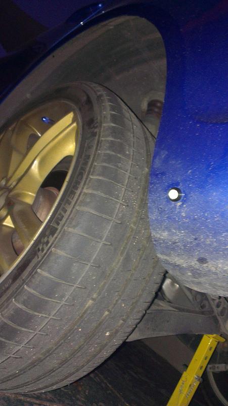

    Neat little inconspicuous circle. I could have gone lower with it, but I wanted it clear of mud
    Decent output! This is with the car jacked up and wheels off the ground... And the curb non-existant. It will seem brighter ones those two factors are opposite

    Anyhow, below is a pic of the wiring attachment, I need to figure out which wire, but the back of the light plate confuses me! Im not 100% sure whats going where as it looks like a big loop. You have an indicator light, park light, brake light, and reverse light.
    Can someone tell me which one to hook in to, what voltage it is and if I need to bother with resistors (and CEL warnings for that matter ), and what type of light? I have some cheapo fog lights sitting around...

    The brown one, judging by the pics.

      If its that one, I wonder do I need to hook the negative up to the negative on this switch or ground it on the body. I already have a convenient little ground point in the area

        Just ground to body, although you'd wanna set up a circuit with a relay.
