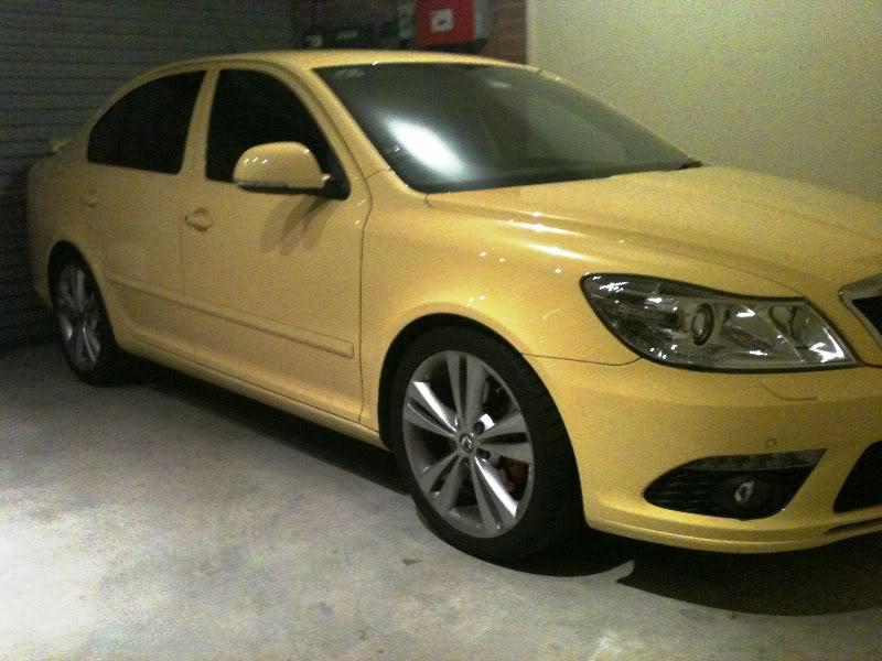

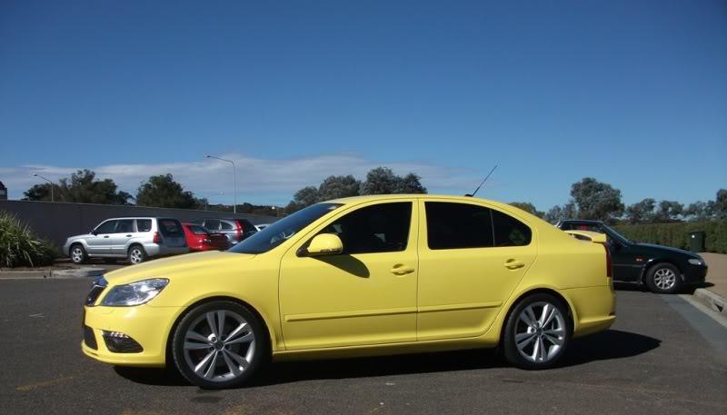

                          • as per my build timeline - facelift (MY11)
                            i'm sure i measured mine from guard lip to wheel hub centre. i took the measurements soon after they were installed.
                            looking at ur pics, n ur measurements - i c no difference, as u said.
                            is urs a dsg/manual?
                            i believe there weight differences between the above two can also b a factor.
                            also, wagon vs liftback springs might have an impact on the rear 'droppings'.
                            liftback = 10-79-004-02-22
                            wagon = 10-79-004-04-22
                            this was mine on the day the springs got installed.....
                            this was after a couple of weeks......

                            • There's no way with those measurements in the 670mm range that you measured to the centre of the hub DS. You've measured from the ground surface for sure.

                              And there is a slight difference in the overall wheel arch spacing....it's just that you can't tell much from those pics of mine above due to differing shadows on the tyres in the pics.
