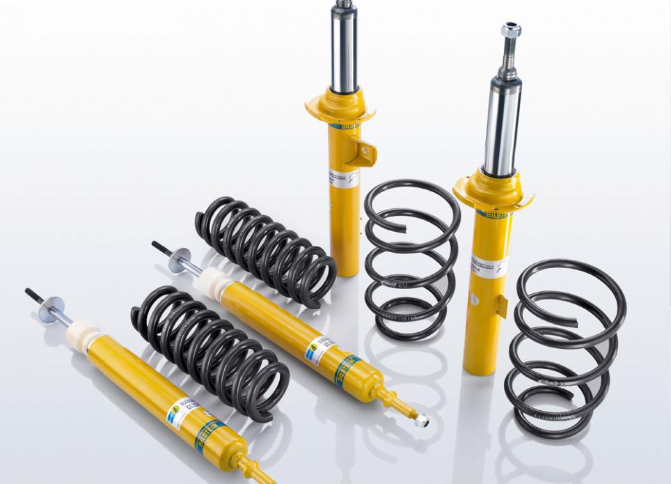

              I have been doing some more research and have found that with the RS chassis already being 15mm lower than the standard models, the drop only appears to be 30-35mm with the H&R kit. Looking at what limited pictures I can find, the drop appears to be a good fit for the car on 18" wheels.
              Another alternative I have found is the Bilstein B12 Sportline kit which lists a 50mm drop, but realistically goes to 35mm and this appears to be a very popular combination on Briskoda. It pairs Eibach Pro Kit springs with Bilstein inverted shocks as a matched set. Briskoda members have said that this helps handling greatly and seemingly improves on the ride quality with stiffer damping but softer rebound.
              I could theoretically get this kit delivered for around $1,000 from the UK or Germany.

                I do now have the Eibach B12 Pro Kit in my Octavia
                It was meant to give something like 40mm lower
                It's a little lower than stock, but not as low as the VWR
                Maybe you have to specifically ask for the lowering option/version
                I'm not disapointed at missing out on the lowering - I no longer have any usability issues
                (And the roll center has not been messed up)
                The ride with these is a wonderful combination of comfort and performance
                The damping and stable/firm handling is just wonderful - I'm totally satisfied
                (It's a hell of a lot better than lower/harder springs on stock shocks)
                Oz price is $1,136 + GST - Oz Eibach URL: B12 Pro Kit - Eibach Springs

                  My understanding is that the low version is known as the B12 'Sportline' kit whereas you may have the Pro kit which sits slightly higher. The sportline springs are red and the 'low version', but the black ones like yours are the pro kit. The quote of up to 40mm is based on the standard Octavia chassis, not the RS.
                  My investigation just got a little harder!!
