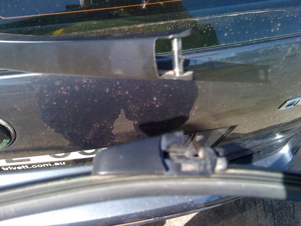

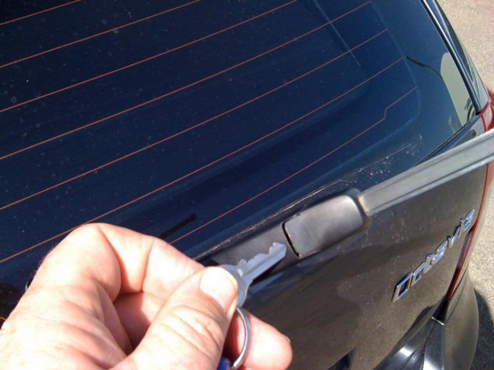

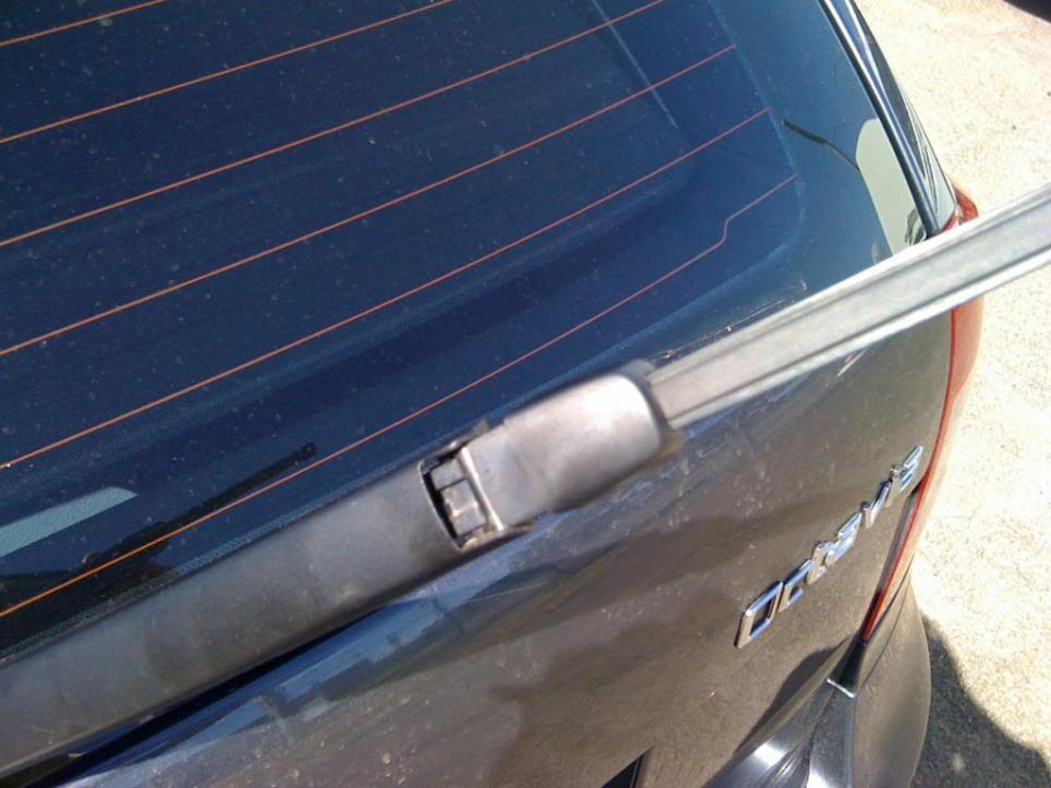

                              The vid shows the method applicable to an Octy's front wipers. I've got a wagon, and the rear is different. There's a plastic cap at the wiper blade pivot/anchor point. Lift the rear wagon wiper away from the glass, and slide the the plastic cap away from the wiper arm (Unless your standing on your head that'd be to the right). No great force needed, but if it's tight you can use the slot between the cap and the wiper arm to gently pry it away. Once the cap is back turn the wiper blade so it's perpendicular to the wiper arm, and it will come away from the wiper arm. My photographic skills are non-existent, but these might show what I'm on about.
