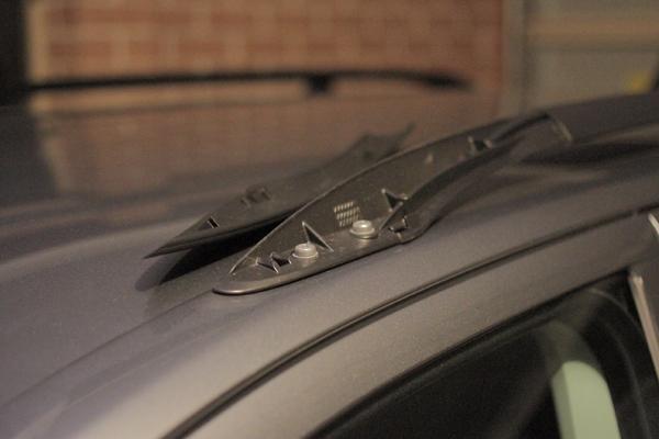

It was a bit tricky, but with a bit of courage and patience, I started with pulling the top edge of the front rail panel towards me. As soon as I felt some tabs unclip and the top edge was free, I slowly worked on pulling out the bottom edge. The last to go was a tab underneath the right/back side which I didn't expect.

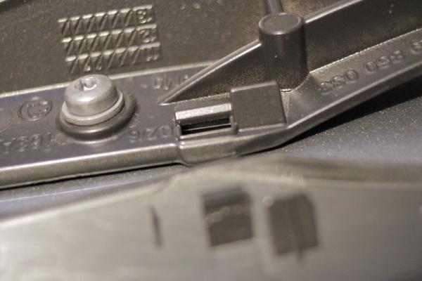

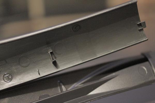

First set of tabs. (from front to back / left to right)

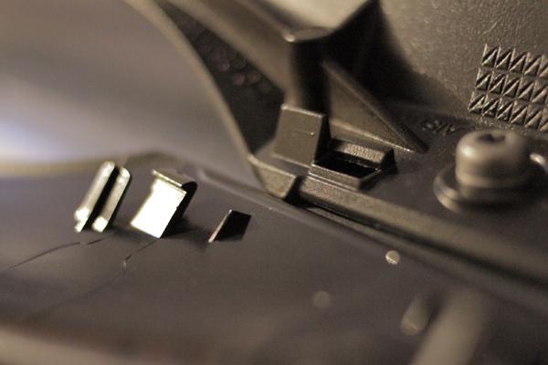

Second set of tabs.

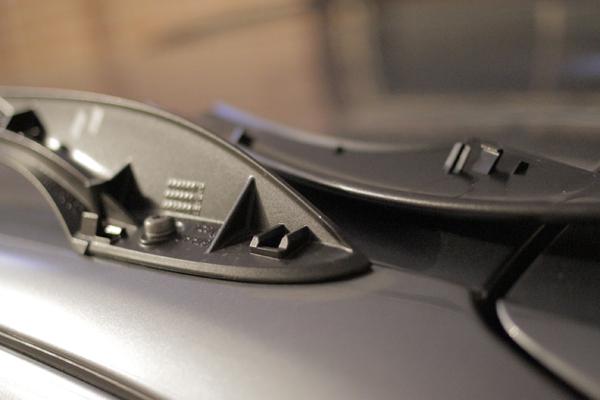

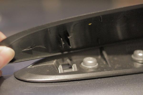

The third tab and the surprise fourth side tab.

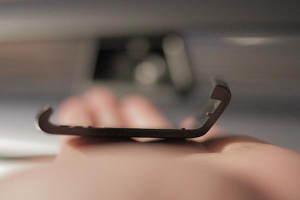

Front panel off.

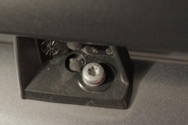

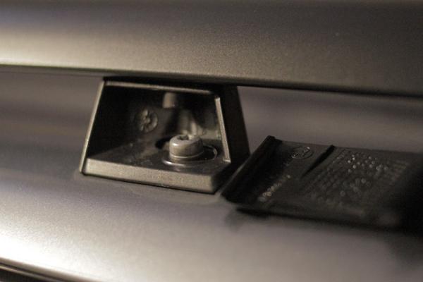

Close up of the screw. Torx, haven't checked what size just yet.

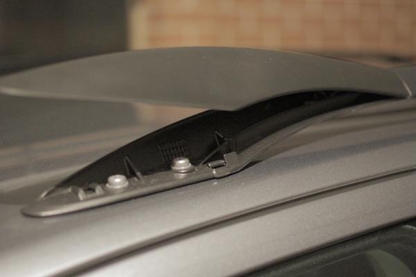

Back panel off. It's essentially the same as the front panel, just in reverse.

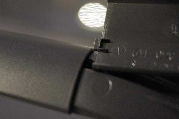

Close-up of the fourth tab at the rear. This should be the last to pull out / first to put back in.
Second set of tabs.
Front panel off.
