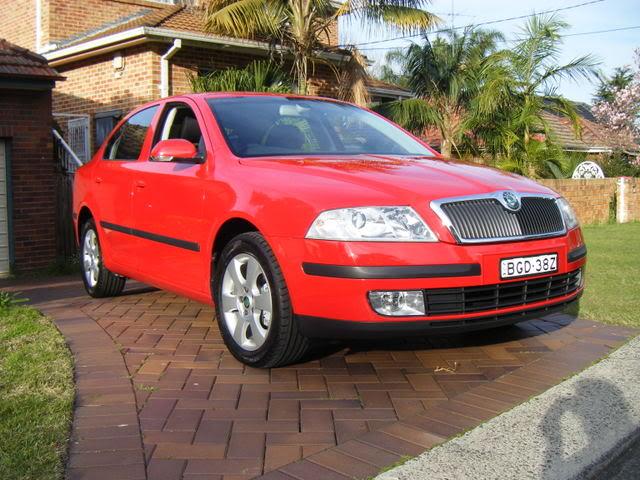

                              I have an Octavia Elegance hatch, so it's a bit LandCruiser-like in it's stance. I've never experienced any tyre rubbing with any of the tyre/rim combos I've run. The cuurrent tyre is a Michelin Primacy HP.
                              My current 16x7.5 rims extend 13mm closer to both the strut & guard than the 16x6.5 you have. The edge of the front tyre sits level with the lip of the guard; the edge of the back tyre sits 20mm inboard of the guard lip.
                              The 17x8 ET35 BBS rims extended 34mm outwards. The fronts poked outside the guards & the rears were level. The extra offset stuffed up the feel of the handling.
                              I like your idea of 215/55x16. There's a reasonable selection in 93V/W - not much in XL/99 though.
                              The other size to consider is 225/50x16. You get a lot more choice of performance tyres in that size. Load rating is generally 92 with V or W speed ratings.
                              I haven't any photos with the 16x7.5 but here are some with your new rims & the BBS
                              OEM
                              OEM
                              BBS
                              BBS
                              OEM Landcruiser-like stance
