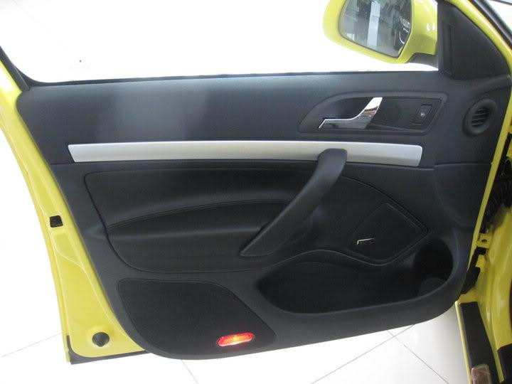

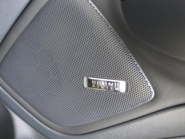

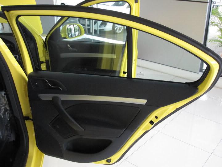

      there is an upgraded 12-speaker "sound system" available as a factory option, in certain countries.
      the folks over in NZ get it as standard.
      there is an extra speaker in each door (above the pockets), hence an additional 4 speakers. i'm not sure how the configuration (sub, tweeter, midrange etc etc) is changed.

              thanks for those pics! I've got the front doors only setup in my baseline ambiente, going to fit out the back doors with some speakers soon but I might try and fit in the extra speakers aswell.
                Are you planning on running surround sound in your car? If so by all means upgrade the rear speakers, but if not, better to spend the money on better front speakers or sound deaden your front doors to help reduce vibrations and improve mid-bass. Rears are a waste of time unless you want surround sound for multimedia or carry passengers in the rear frequently.
                I'd love to be able to go to town on my upcoming Passat in terms of sound, but I just don't have 10k to spend on it like my last car.
                  hah - I'm thinking of spending maybe $2-300
                  Thanks for the deadening tip - I will add some to the front doors but I'll still put in the rear door speakers - its not that difficult and I'm not going to town on it. I just reckon the more speakers I can put in factory holes the better...

                    I'm actually reasonably happy with the quality of the rig in the vRS (I'm an audiophile from way back). However, def looking to upgrad the front splits (I have some Boston Acoustic 6 1/2's that should do nicely) and add a smalll amp to drive them (old Alpine). And also deaden the front doors too. That should hopefully should tighten things up a bit.
                    Would love to have the little forward mounted mid-range speaker as shown in the photo - would improve imaging/staging heaps I reakon.
