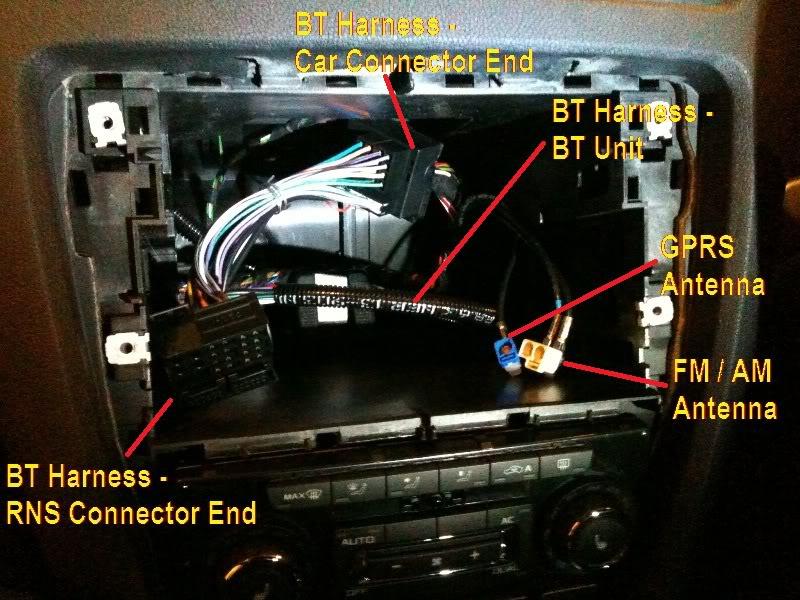

the bt unit did not come with the bluetooth wiring harness, so i bought it from ebay - bluewagen.
its the complete deal - literally plug n play. i didn't have to do a single thing with wiring, but simply plug the ends together. it even has the MDI bit, so no need to transfer it from the car's connector to the bt harness wiring.

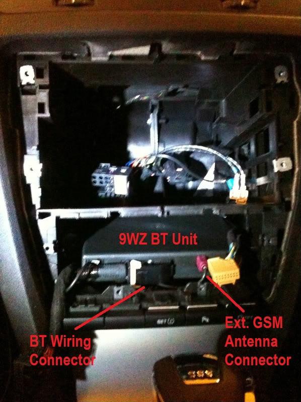

my original plan of putting the unit upright beside the glovebox, towards the passenger door, failed. not enough room.

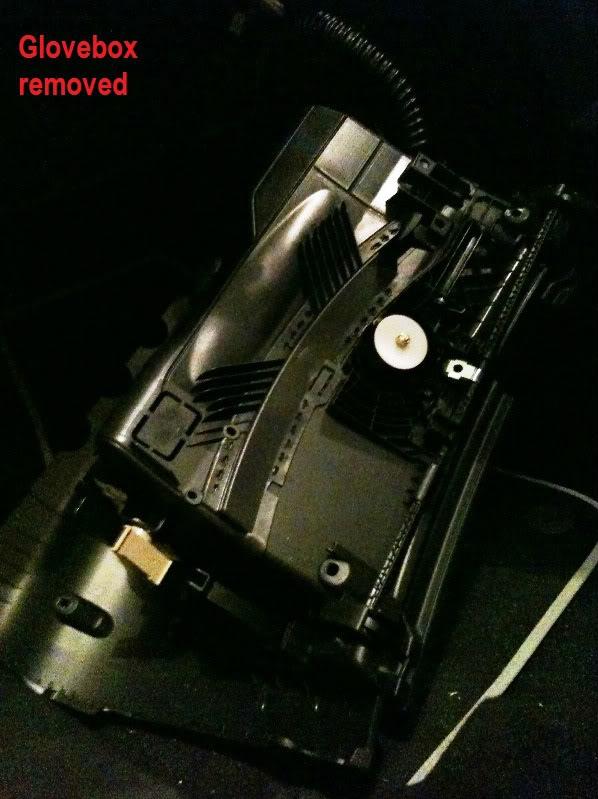

plan b was behind the glovebox. again no room there.

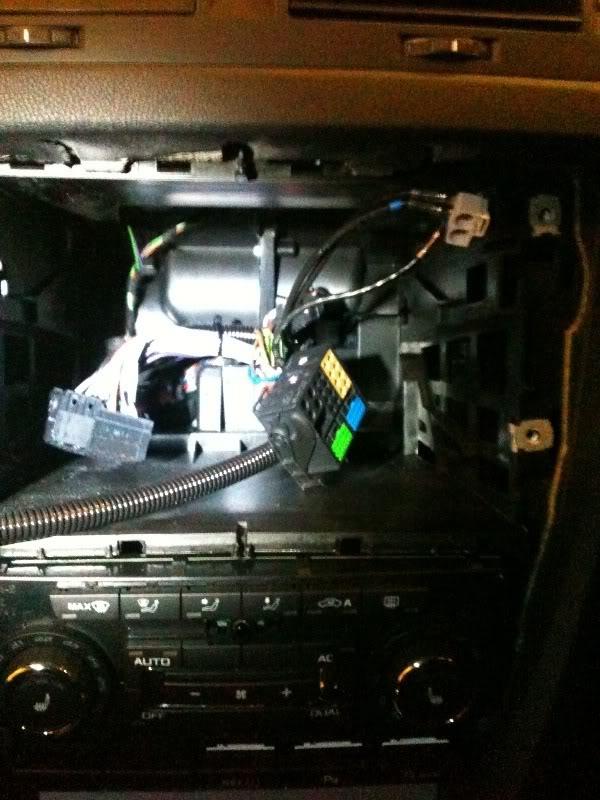

plan c was behind the headunit. fark no, i couldn't even put a cigratte box there, let alone the bt wiring harness!!

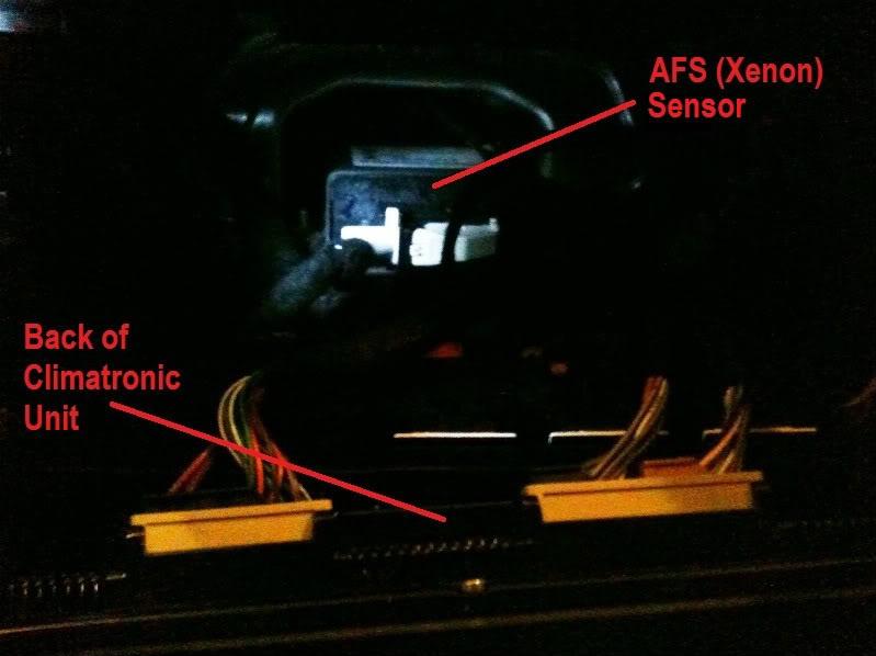

plan d was behind the climatronic controls. this plan was almost foiled by the fact that these was a small black box sitting in there - its an afs sensor, used for the xenon lights leveling.
luck me, with careful adjustment, i was able to place the bt unit above it, connect the bt wiring harness, external gsm antenna, with enough room for the climatronic and its wiring to fit back in place.
plan e was under the passenger seat. i wanted to avoid removing the door sills & carpet at all cost, so i made sure plan d was my last stop
that done, i was pleased, now to connect the headunit, put it all back & its all good. boy was i wrong!! wiring was piss easy, as all i had to do was plug it all together, after that it went down hill!! i spent the next 2 hrs trying to tuck everything (bt wiring, bt quadlock & headunit quadlock), in behind the headunit!!! fark me it was a pain in the royal a55. no matter how i crafted the wiring connectors, i could not get the friggin headunit all the way in. anyways, at 1am, persitance prevailed, i managed to get most of the wiring & quadlock connectors out of the way by tucking it next the glovebox.

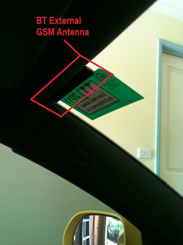

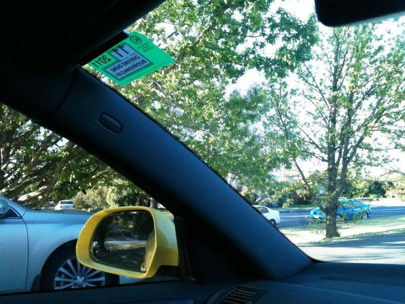

i ran the bt gsm external antenna behind the glovebox, and up the a-pillar (without actually removing it) and mounted it in the topmost corner inside the windscreen. can't even notice it. reception is awesome when in rsap mode thanks to this antenna.
