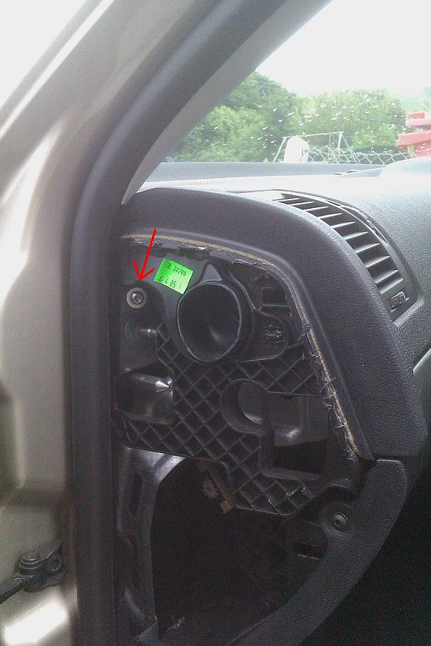

              We have 2 Octavia's: a 90TSI & a RS, which both have the rattle in the dash on the passenger side. The problem is a single torx-screw that secures the dash. Sometimes tightening the screw works, but in my case it was too tight and slightly loosening it fixed the issue. You can even replicate the noise by pressing on or around the screw, just to make sure that is the problem.
              Below is a link to a photo showing the problem screw (courtesy of Briskoda):
              http://www.samahill.co.uk/img40.jpg

                Thanks for the info Ausspace. Unfortunately i found that same thread a couple of months back and have probably tested every possible rotation of the screw as well as stuffing all sorts of foam and padding in that general area, with no luck.
                My sound is probably more of a squeaking/rubbing noise with a healthy dose of rattle/click (like the plastic is being stressed) the only way I can seem to stop it is by having the passenger "lift" the whole dash area, unfortunately I haven't had much luck convincing someone to do this on a permanent basis.
