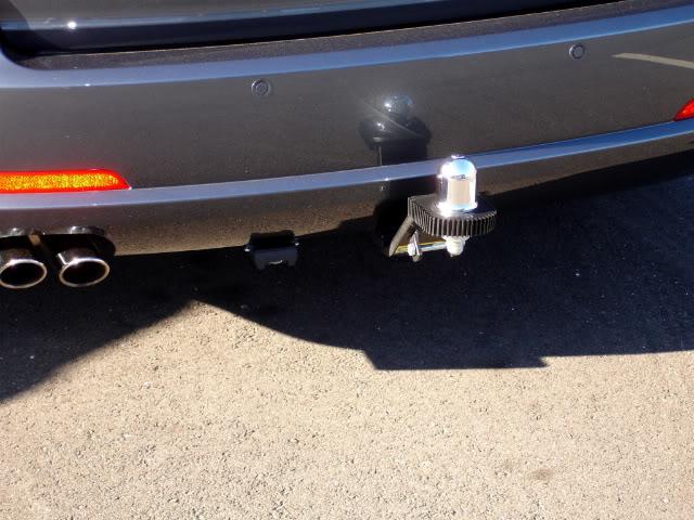

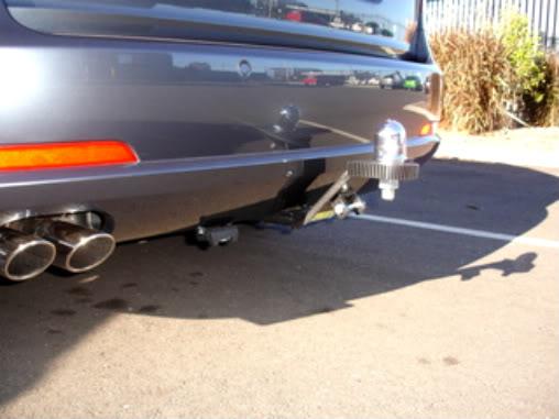

I opted for a standards towbar (two bolt tongue) from Jim at Cosmopolitan with the same wiring as described above for $590 fitted and wired. It is the same bar that he uses for Golf wagons, and required so little cutting of the rear bumper as not to be noticeable. The 7 pin flat socket was fitted very neatly with no cabling visible. The bar provides the same if not better ground clearance than the HR, and has 1000kg towing capacity and a 70kg rated ball dead weight, which is plenty for a bike rack.
