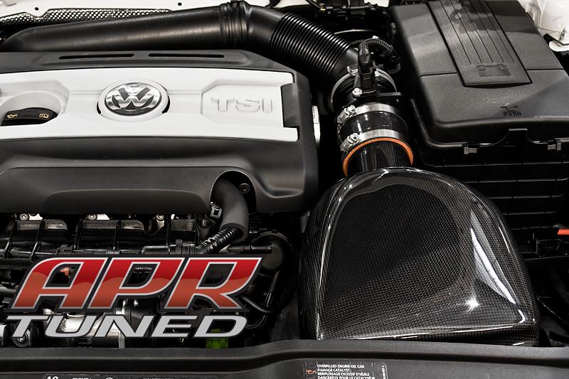

      there is only a difference in terms of the piping integration.
      tfsi engine - notice most of the tubing is incorporated into the engine cover
      tsi engine - notice the extra bit of tubing, taking it to the back of the engine and across.

        So pretty much if I order a Mk6 TSI carbonio then it will fit my 1.8 TSI. (so 1.8 and 2.0 TSI carbonio's are the same??)

              The US website states that there is a 1.8TSI VW Carbonio intake.
              and they also state that the 1.8 and 2.0TSI intake is the same.

                      apparently this unit is sealed completely from the engine bay and is designed to reduce intake temperatures...i think there would be a small gain in performance, but would be more noticeable with a tune combined.

                              The heat side of things is neglidgeable, but more so to do with airflow - the APR's use the stock air inlet as it is already in the best high pressure position to get optimal cold air into the airbox. The difference is that the APR allows the air to flow directly into the intake, where as the stock airbox, the airflow is directed down, then back up through the airfilter, then again at 90 degrees before reaching the same point the APR attaches to the intake. The other difference is the stock airbox intake doesn't allow the full air charge ( have a look at the front of the intake - you'll notice the mouth of the airbox intake only takes up half the ram duct ) to enter the box, where as the APR allows for some more.
                              Also the APR uses a fully enclosed pod filter which is "supposed" to offer better air flow but I'll let people decide that for themselves as there is many varied opinions on that.
                              The benefit of running an APR CAI is that it allows the Turbo to spool up quicker ( more noticeable on Turbo diesels ) , it "may" offer some economy increase with improved intake airflow, and you will notice a little more air intake noise/turbo spooling but nothing like the Open Pod Filters you find on some "ricer' type cars . And for anyone who has a diesel Skoda and likes the idea of fitting a provent, the APR Intake free's up a bunch of space that you can mount the Provent in.
