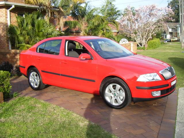

I have Eibach RS diesel wagon springs on my hatch and it did lower it but not huge amounts (25mm?) which suited me fine as I mainly wanted the higher spring rate.
looks like this with 225/50r17 tyres. NB they are 13mm bigger radius so make the drop appear to be more than it is:
Compared to this with 205/55r16 (the bak gap is exagerated slightly because of the driveway profile)
It's not a big difference
