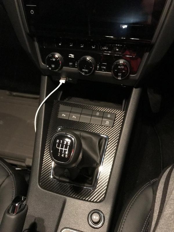

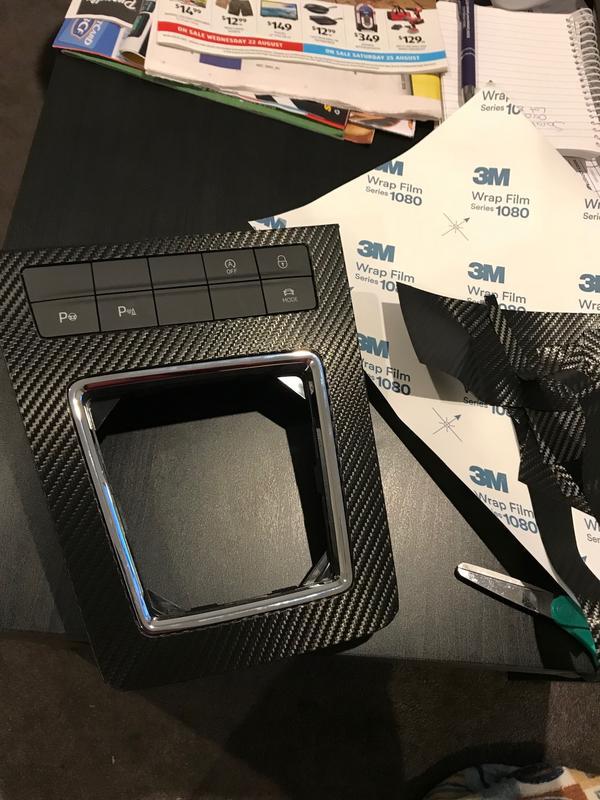

                Ended up getting sick of Piano Black finish... had the car almost a week and it's smudgey and scratchy...
                Wrapped it! 3M vinyl film.
