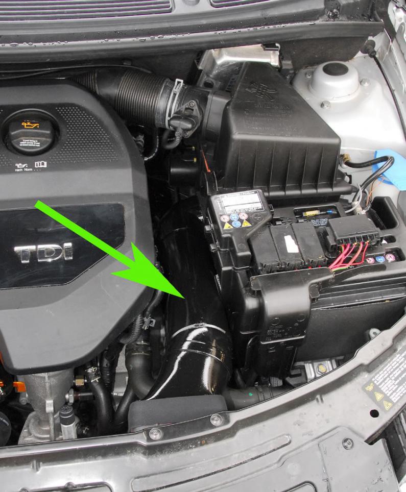

    New intake....

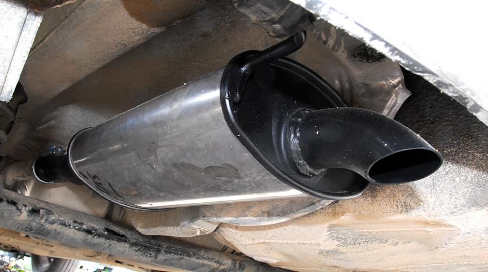

    New muffler...

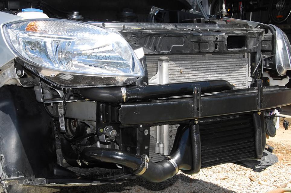

    New intercooler...

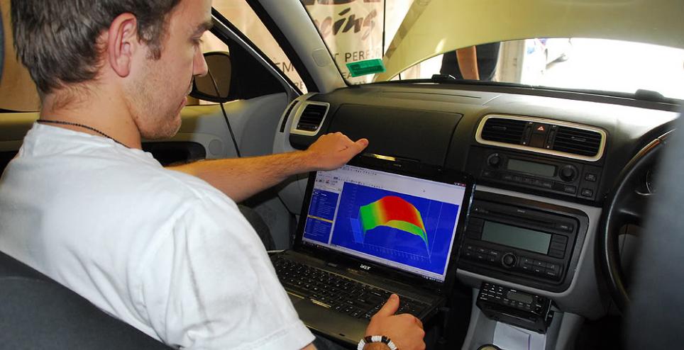

    Custom reflash...

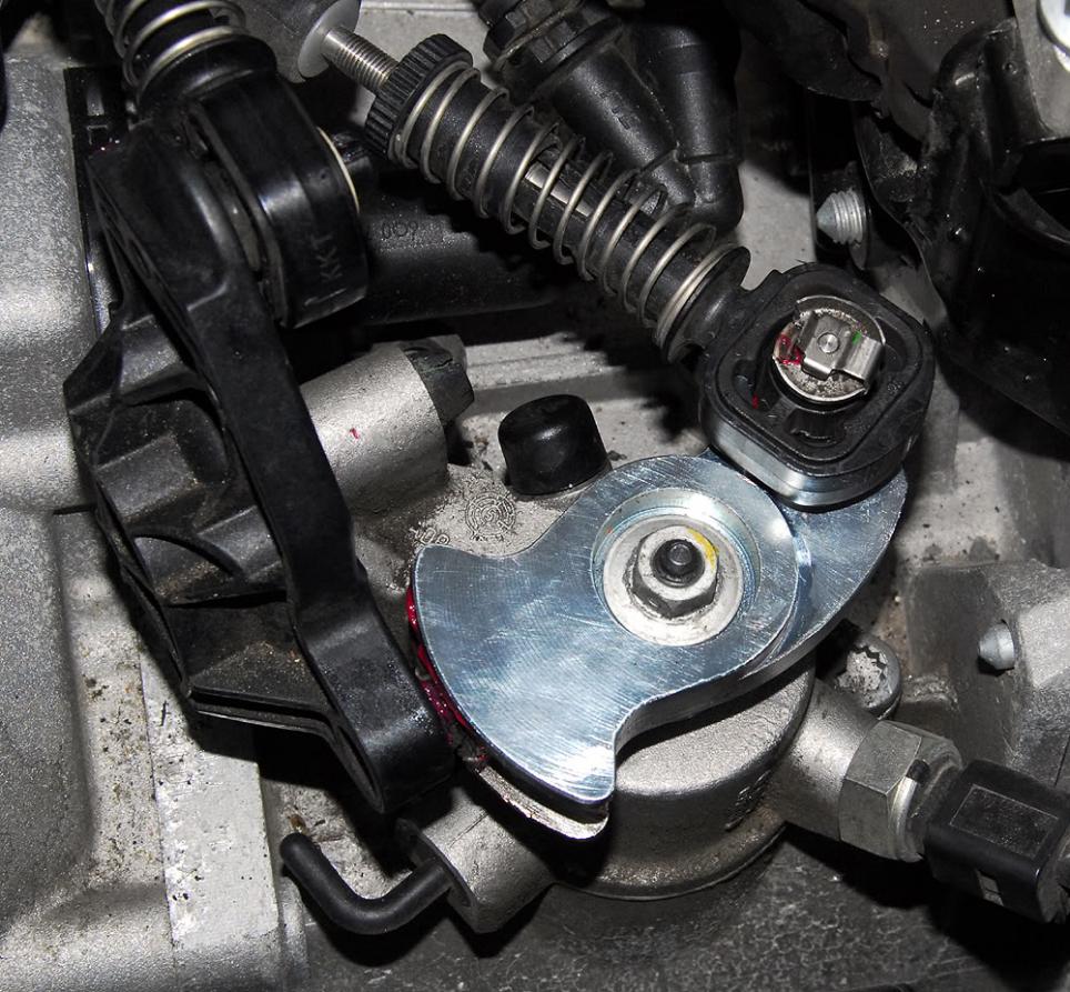

    Forge short shift...

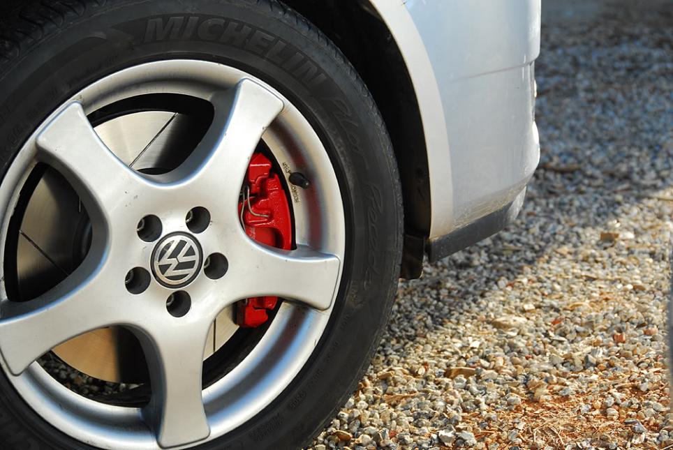

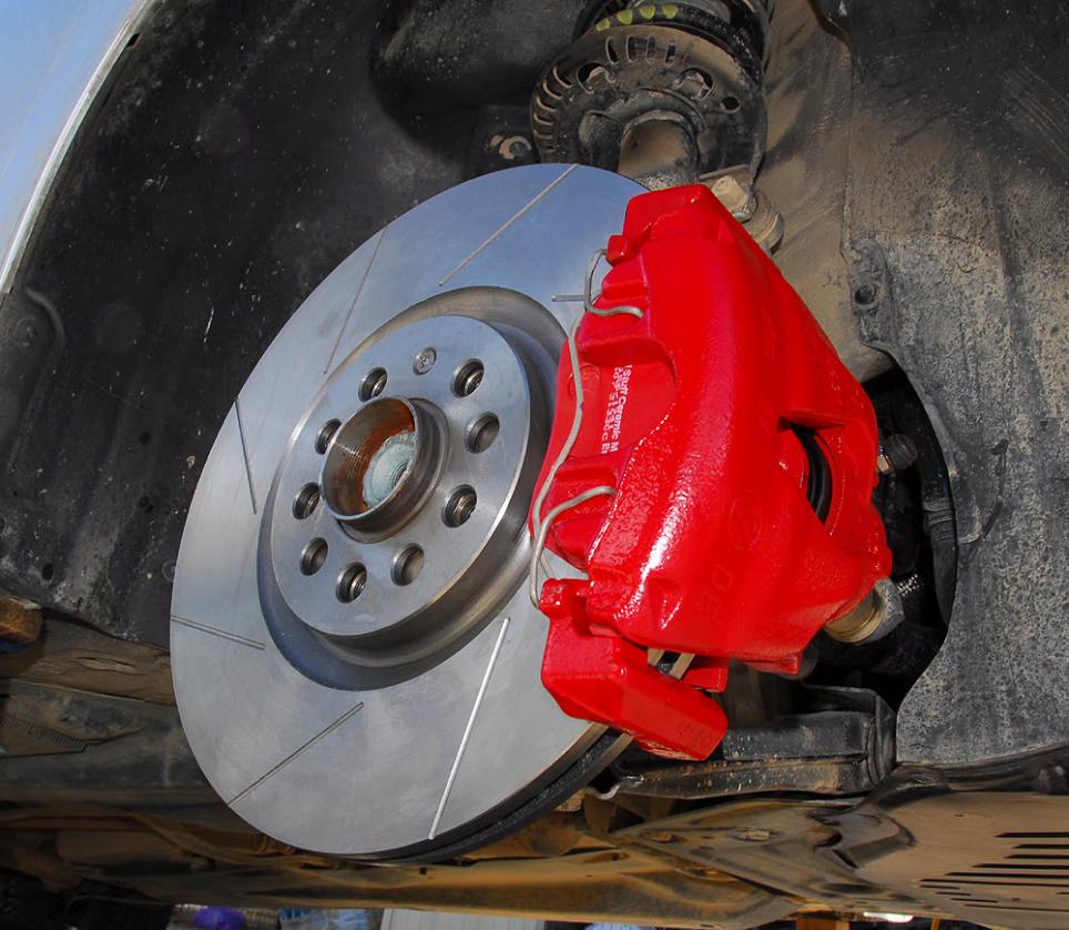

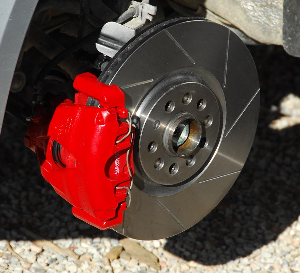

                    New front brakes.
                    312mm slotted RDA discs, Audi TT calipers, Audi TT caliper mounts, EBC 'red' pads. (16 inch Vento wheels)
                    Initial impressions very positive.
                    My books: http://amazon.com/author/julianedgar

                            On the road the brake upgrade results are excellent.
                            The brake bias is clearly more to the front, but this is noticeable only when reversing down a steep gravel driveway, where the fronts will ABS earlier than before.
                            The ability of the brakes to pull the car down from high speed with progression and feel is superb – vastly better than with the standard brakes. On a back road (hmm, I mean the track) you can drop from 150 to 60 km/h with literally a gentle push of the centre pedal – and do it corner after corner. In an emergency stop the ABS operates as it did with the standard brakes.
                            Downsides? There are some.
                            When the brakes are dead cold (in my normal daily drive I arrive at a roundabout after 30 kilometres of country driving that has had literally no brake applications at all) the pedal needs a distinctively firmer push. In normal urban braking that doesn’t occur (the brakes must retain some heat) and in spirited driving the pedal effort is clearly lower than with the standard brakes.
                            Each new disc has a mass that is 1.4kg greater than standard (interestingly, the new calipers and pads are 200 grams lighter than the old ones) and the Roomster is a car where the 1.2kg increase per side in unsprung weight can be clearly felt. When I went from 15 to 16 inch wheels, the latter fitted with larger tyres, I could feel the increase in unsprung weight, and the same has occurred with the new front brakes. The result is that over lumpy bitumen, the car does not ride as well.
                            Overall? Very impressive.
                              Well done on the braking mods.
                              I have a set of EBC Reds to go into the Octavia. When i ran them on my previous car i found i required a slightly firmer push of the pedal on the first stop of the day then they were fine. During spirited driving they were much better at handling the heat then the stock pads. Stopping distances felt shorter too. Not sure why when the tyre is the limiting factor?
                              I also found then to be quite gentle on the rotors which is great for a aggressive pad. I had them in for 40,000k's before i changed the front pads. Front rotors were still ok.
