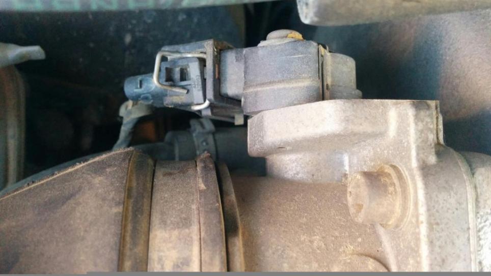

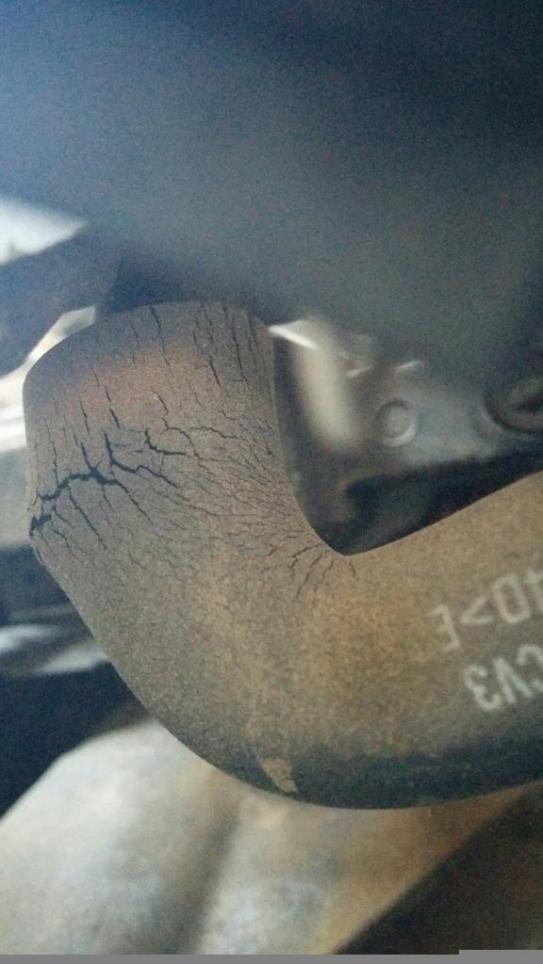

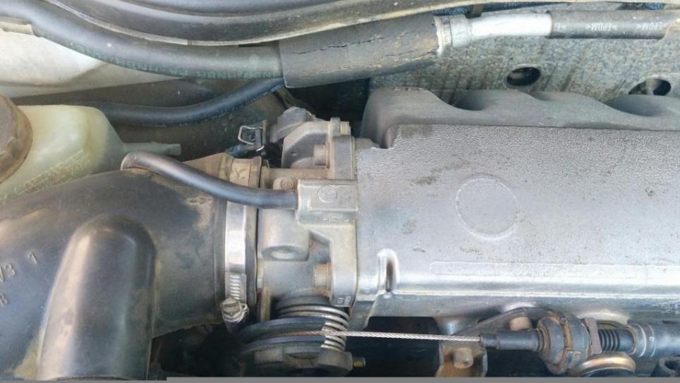

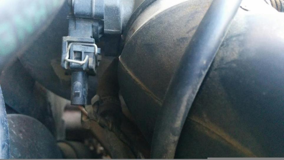

                      Originally posted by Golf Loon View Post
                      On the underside of the throttle body at the back is a rubber elbow. Bet it has a split in it.
                      Hey Golf Loon again, I think I have located the rubber elbow you were talking about.
                      Here are some diagnostic/location pics.
                      Hope this is what you mean.
                      2007 Volkswagen Golf, MKV GTi, Schtock, RED
                      1998 Seat Ibiza Cupra, ABF 2.0L 16V, BLAAAAAAAAACK, WEEKEND BABY
                      1995 Seat Ibiza GTi, 2E 2.0L 8V, 15" E30 Rims, Alpine White. RACECAR!
                      "I drive a Volkswagon - Therefore, by default I am better than you!"
                        Hope that fixes the issue for you. Check also that the brake booster line has no splits or open ports on the one way valve.
