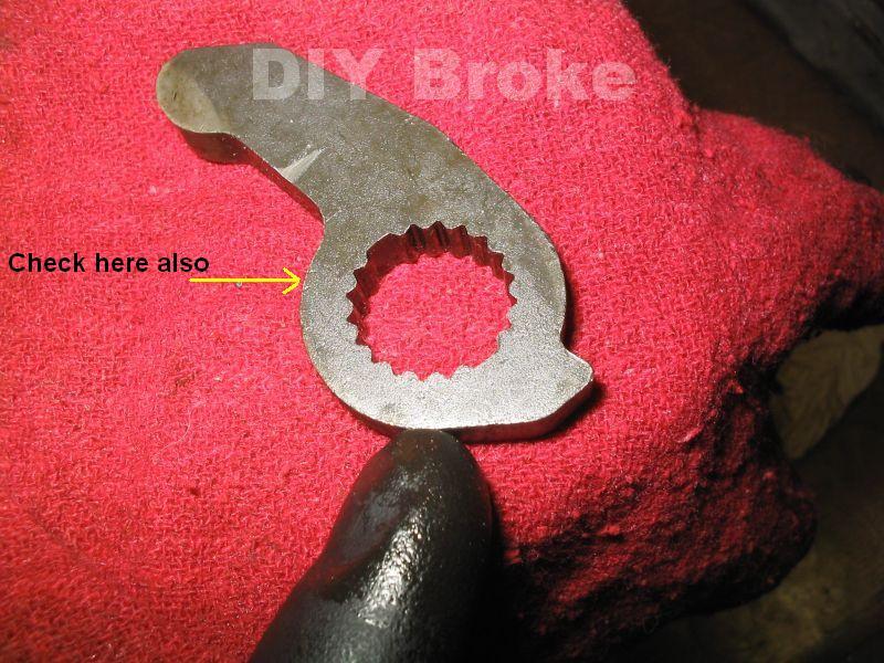

Not sure if you have the same issue, but mine was a broken Finger - I think it was $70 from VW... All of 30-45min to fix. No need to remove any heavy parts. The worst thing is I only discovered it was the finger after dropping the entire box, replacing the entire clutch plate and pressure plate, clutch cable and almost replaced the peddel box too. The brokevw site saved me another 10hour job.
see half way down this page: TO Bearing
I agree it sounds like the finger in the back of the box. Behind the passenger rd wheel, remove green cap on end of gearbox. See if finger is broken. If it has auto adjusting clutch cable compress and hold it before you dismantle it.sigpic Camden GTI Performance. VW / AUDI Specialists

First, check that when the clutch pedal is pushed down that the big lever on the front of the gearbox is moveing up (you'll need someone to watch either the lever or push the clutch) If it doesnt move up when the clutch is depressed, then the problem is likely with the cable.
If the lever is moving up, then most likely the problem is the release lever finger as pictured above.'07 Touareg V6 TDI with air suspension
