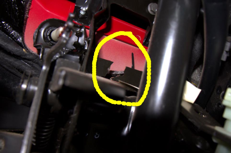

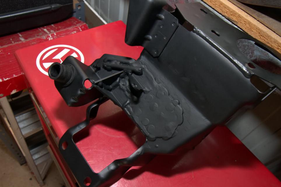

Hi all,
I went to select first to put the car in the garage last night & heard a pop followed by the clutch pedal going to the floor. Had a quick look today & the clutch cable support is well & truly free of the pedal box. I was hoping to do the bolt mod ( had a good look at the FAQ on cupra.net) but my failure looks much worse than the ones shown.
Anyway, could have been much worse, having it fail in your own driveway is probably the best I could have asked for!
So, options?????
I'm thinking,
1. pull it out & rebuild it.
2. get 2nd hand one & strengthen it/ repair mine as a spare.
3. try & get a new one from somewhere.
Loon can you help with option 2 or 3?

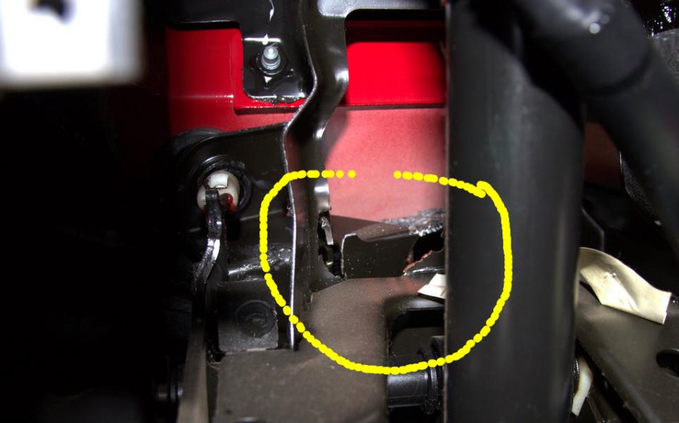

This is with the clutch cable still connected so the bracket is under tension
Now with the cable disconnected, I don't know where the missing section is????
