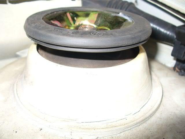

            What is of more immediate concern is the front passenger side strut top mount.
            I checked the fronts pass side first as I was convinced that was where the prob lie. I jacked the side of the car up, removed wheel and as I was fiddling around, discovered that the strut was flopping around at the top mount.
            Short story, I tried to tighten it, then removed the strut, removed coil spring, ascertained that everything was there (I think), put it back together and reinstalled it.
            The problem is that the upper rubber mount just sits freely in the strut tower.
            In the pic you can see the gap between the bottom of the cap and the top of the tower. Surely the strut should be a tight fit into the tower? The way it is, when the car is jacked up the strut drops by that amount between the cap and strut tower. The rubber mount itself looks fine, although it may well be compressed - I've got nothing to compare it with.
            Comments anyone?

              if i remember correctly the tower is loose if it is jacked up under the suspension
              double check the top nut any way and see what it is like when all wheels on ground.

                  Is it correct that the upper strut rubber just "sits" in the tower?
                  I guess if it works, it works, but I've never come across it before.
                    I dont see anything wrong with that strut mate. It should sit like that.
                    If you are doing the bearings yourself remember they are tapered and you need to adjust them properly, adjusting as you spin. You should be able to move the thrust washer behind the nut with a little bit of resistance.
                    Jmac
                    Alba European
                      Strut mount is normal as Jimmy says.
