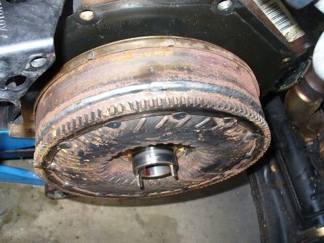

                          Nest question,
                          for exchange purposes is all of the pic regarded as the torque converter or would I have to pull it apart (does it come apart?) and keep the ring gear etc?
                          • #28
                            Thats the torque converter that you were suppossed to leave in the gearbox when you removed it
                            There is a plate behind it which has a hole in it, on the back of the engine with a rubber bung in it.
                            Rotate the flexplate and undo the three nuts as they come round to the hole. 14mm or 15mm.
                            The flexplate should than be attached to the engine and the torque converter should be still in the gearbox.
                            Replace in reverse order.
                            • #29
                              Not much of a challenge doing it the easy way
                              Cheers mate...
