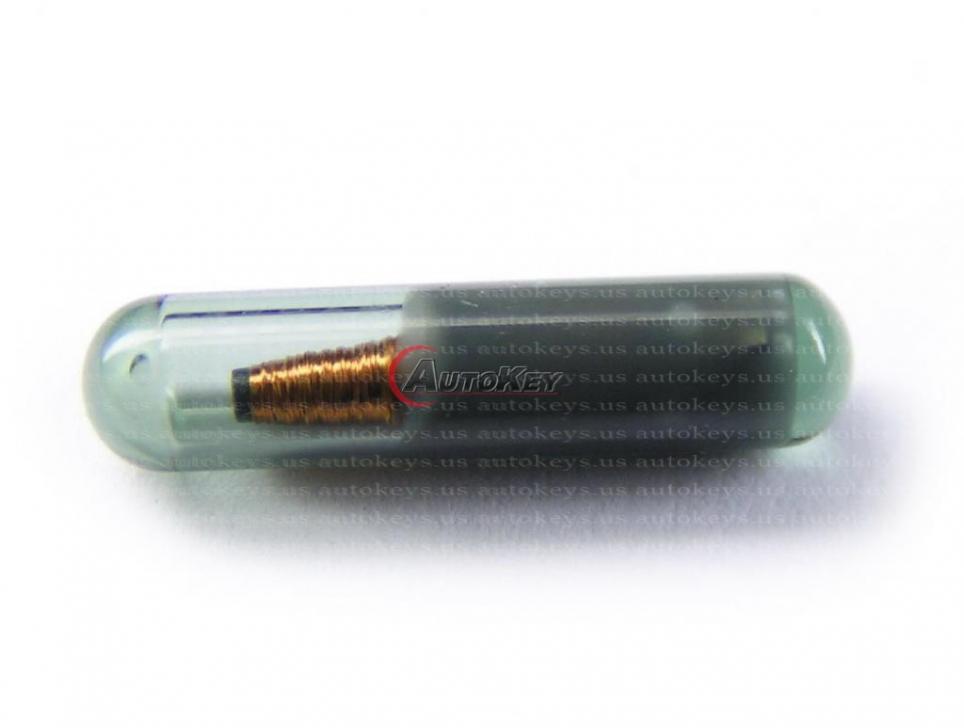

that genuine valet key - you should be able to split the top section into halves - open it up carefully - is there a chip inside??? it's like a grain of rice
