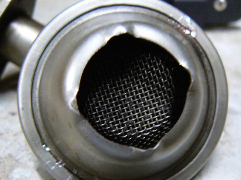

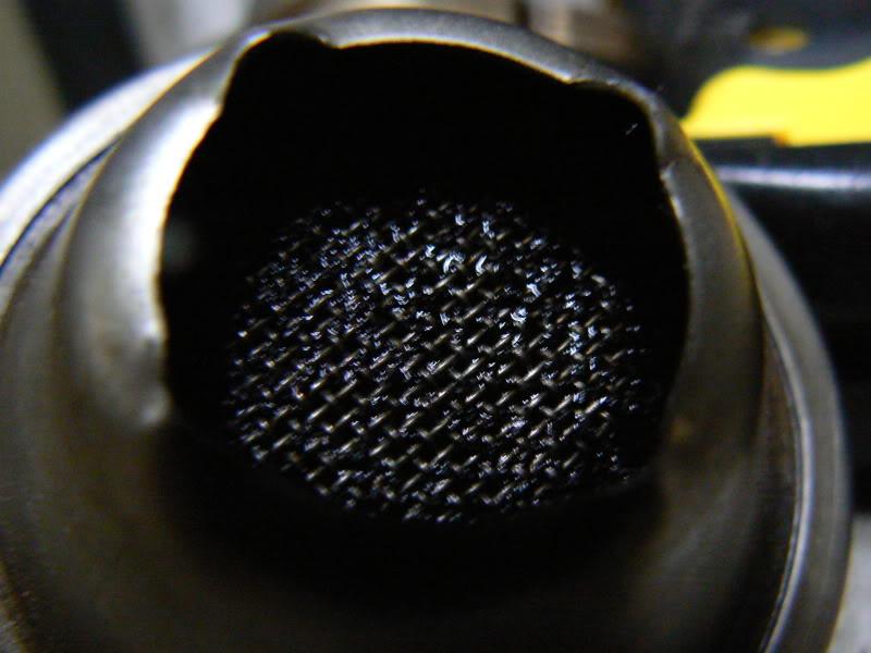

        Some strainer pics.
        before clean
        After clean
        Neil

          Originally posted by t4 camper View Post
          Some strainer pics.
          before clean
          After clean
          Neil
          Nice, and thats the reason i say dont flush, where does it go????? to the strainer. Tough oil pump mate , working its nuts off to work. Itll be relieved too!!
          Cheers
          Jmac
