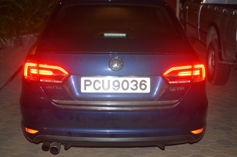

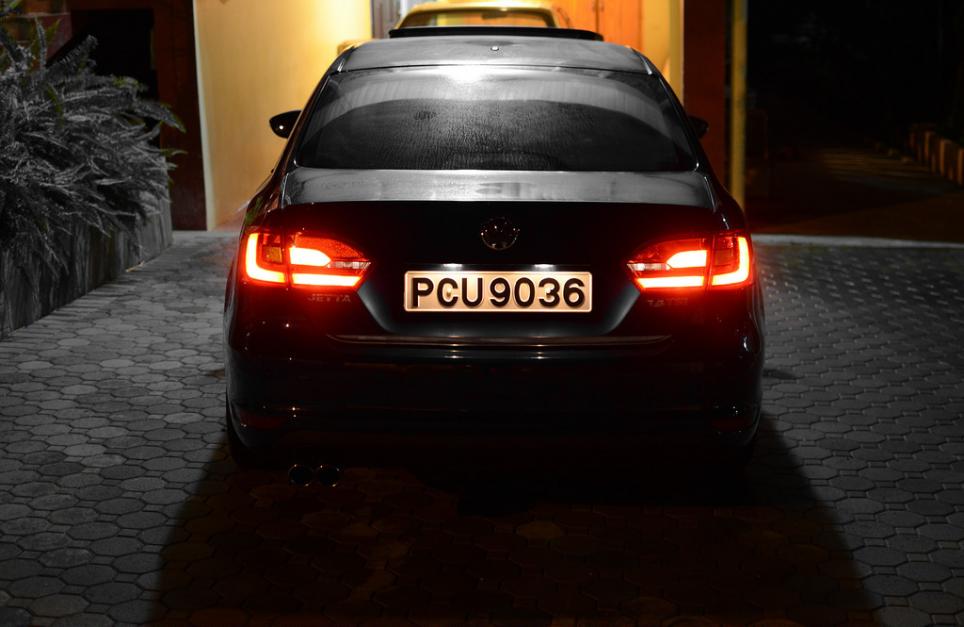

        Got them!

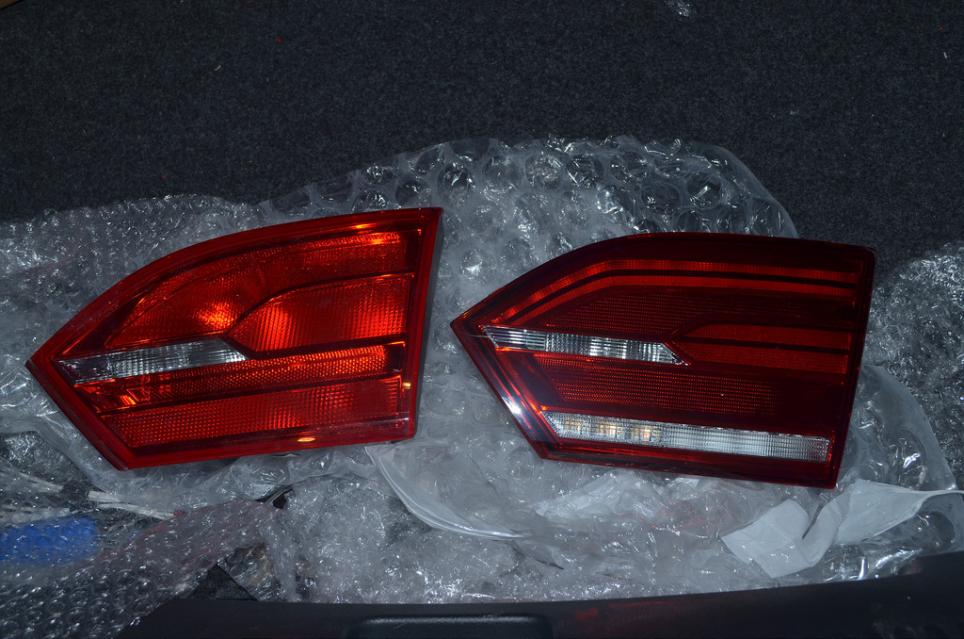

        Stock:
        Stock inner right vs OEM LED inner right:
        OEM LED:

              Genuine OEM. I don't do aftermarket much. They come with adaptors for cars like ours as the stock electrical harnesses do not fit the LED tails. The harnesses are sturdy and felt well made.
              The lights are essentially plug and play once the harnesses are used.
              VCDS is to be used not to enable them but to remove false bulb out errors. I am still looking for the right VCDS code for byte 18 in the CECM. I've seen golf 6 owners use "15" as their solution but that info has been from 2010.
                Coded byte 18 in CECM to "AA" via VCDS long coder. Lights work differently now but I have no bulb out errors. Seems like the car didn't like the brake lights not being on when park lights or headlights were engaged when byte 18 was set to "8C"
