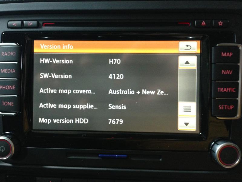

    Hi All,
    Well picked up the new car last week and today tried the Video In Motion. Took 2 attempts:
    ISO - found here - US RNS-510 Video In Motion - Rob86Wiki
    Attempt 1 - Burned the iso with nero on a CD-r at lowest speed(4x)
    FAILED with downgrade error.
    Attempt 2 - Burned with free iso program from the net
    Rebooted - Eject+star+Setup
    When the add CD red bars came up I put in the CDR and all went through to success. CD was ejected and system rebooted.
    Working perfectly
    Thought I would post as I have not seen many posts from people with this model.(H70) Hope it comes up in searches easily.
    RNS510 H70 4120 Australia VIM
