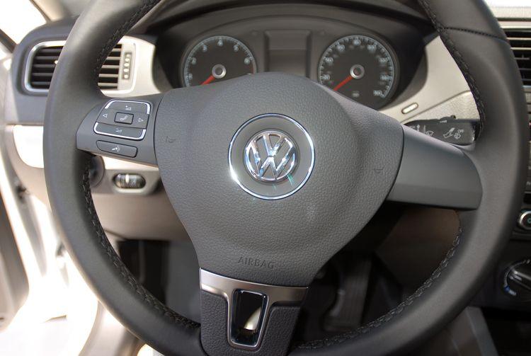

      American steering wheel:
      Euro wheel:

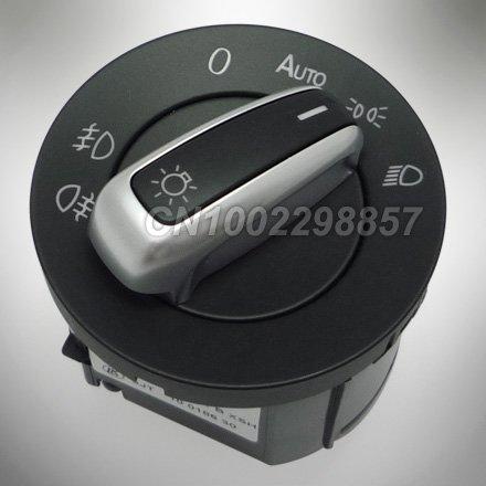

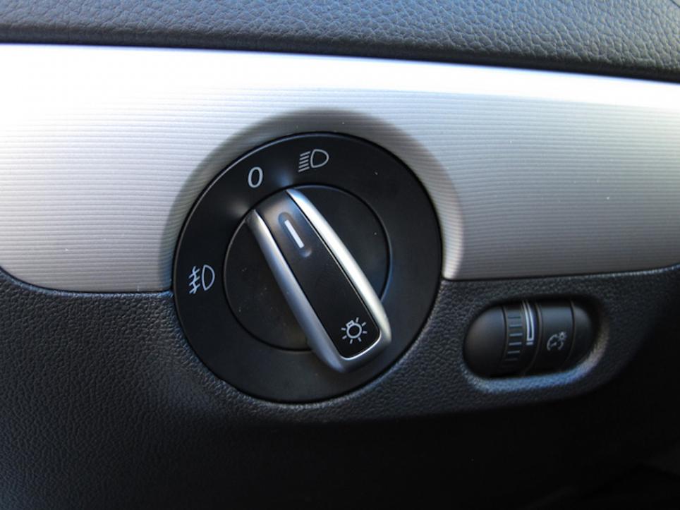

          Yes the American and Euro fog lights are identical, just make sure you don't get the fog lights for the Jetta GLI. You will still need to buy a Euro headlight switch unless you want to wire the fogs to some other setting... like switch it on when your parkers/headlights are on.
          American headlight switch (note there is no "parker light" setting):
          Euro headlight switch:
          Last but not least I think you may need to code this into your car, so better find a VW specialist there in VIC to do it.
