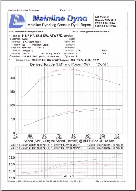

quite similar numbers and rev-range to the 1.4, but see how my old diesel with greater displacement, only 2 valves per cylinder, sizeable turbocharger and mechanical fuel pump makes a much smoother torque curve because there are fewer feedback loops interacting with eachother (very simplistically). (just FIY, the 2 curves are so different because I increased fuelling after the first run)
