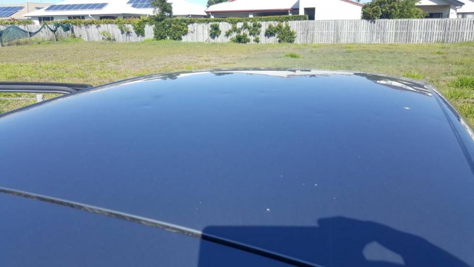

      Are you doing anything about the dents from hail ?
        While I had my roof lining out I tapped most of it out from the inside.......its not perfect but looks much better.
        I still need to put in a session on the bonnet but I suppose since its an older car the internals, engine and suspension its the more important bits. If it drives great the looks are not that important?

            Mine was luckily not too bad. This is a photo from before I had a go at them
            Sent from my SM-N920I using Tapatalk
              You can hardly see them,just like mine.
