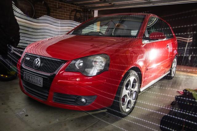

    G'day guys.
    Just picked up a cheapo '08 9N3 GTI. My first VW coming from a fairly modified BMW 330ci.
    Now. Because I thought it had the same 20v Turbo from the Mk4 Golf, I thought it'd go like a stabbed rat. How very wrong I was... I've been told it needs a tune, but we'll get to that later.
    Just picked up some coilovers and a set of OZ Racing Superlight 17s from Italy. Hoping to make it into a bit more of a hot hatch or a slightly spastic track weapon; apparently we can get close to 220hp with a simple ECU reflash, but I'm sceptical of that... Forums are always a good place to start, anyway!
    I look forward to chatting to you all about a bit of VAG.
    Cheers, Ash.
